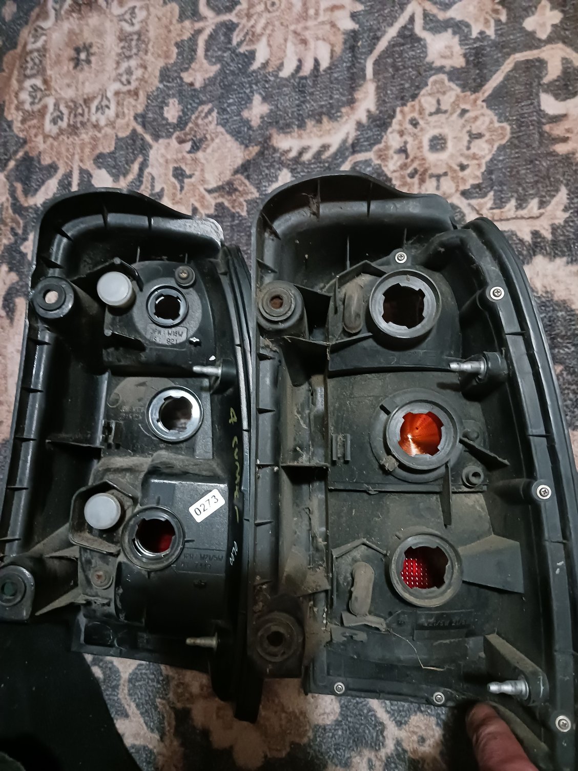

1998 bulb receptacle is smaller than the 1997 Toyota 4Runner
Originally Posted by rob17san
Nice to see you around still rocket. As you know I sell toyota parts. I ask the above question because a lady returned a 01 tail light and I thought they fit 96-02. She said the wiring was different? Either way, I want the newer style for my DD.
the brake bulb fits.blinker and reverse do not as the 98 on left has smaller receptacle than 97
