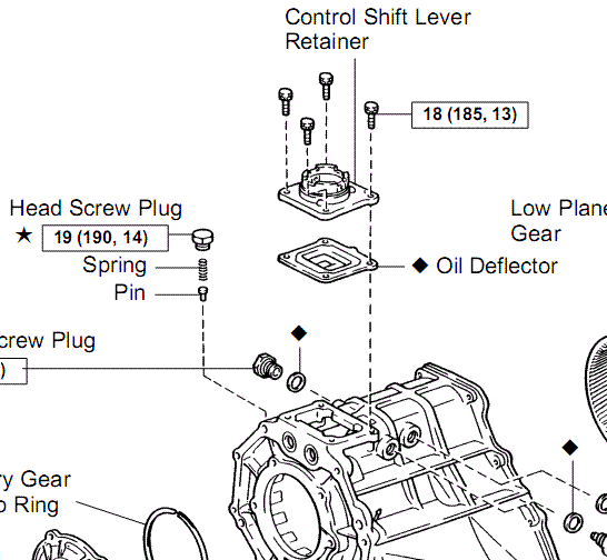

Originally Posted by FogRunner
To pull the shifter out you have to take the plastic bezel out around the shifter between the cup holders and dashboard. After that just the four bolts around the shifter and it pulls out of the transmission. I would recommend getting a gasket from Toyota and putting some RTV silicon or some Toyota FIPG on the gasket.
Also be sure to scrap the gasket off, there was one member recently that had the same problem but had to do it twice because they didn't get all gasket off.
FOG
Hey Fog, I noticed the same leak and am going to replace the gasket, not exactly sure what i need to get from toyota, do I need the "Oil Deflector"?
thanks!
Old May 5, 2010 | 08:10 AM
Qyota's Avatar
Joined: Nov 2009
Posts: 127
FYI, the gasket "oil deflector" part number (at least on my transfer case...99 Limited 4x4 with A340F trans) is 36345-35050
http://www.toyotapartszone.com/oem/t...345-35050.html
