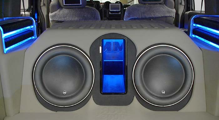

Jeff it all depends on how much power you want, there are alot of good high powered amplifers that are out there that will fit under your seats. The next best option would be somthing similar to what Andrey's done. There is a ton of room behind those quarter trims. It all depends on to what extent your gonna take your system.
Attached Thumbnails What size amp fits under the front seat?-resize-wizard-1.jpg
