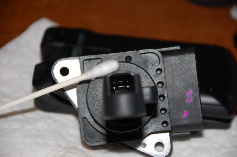

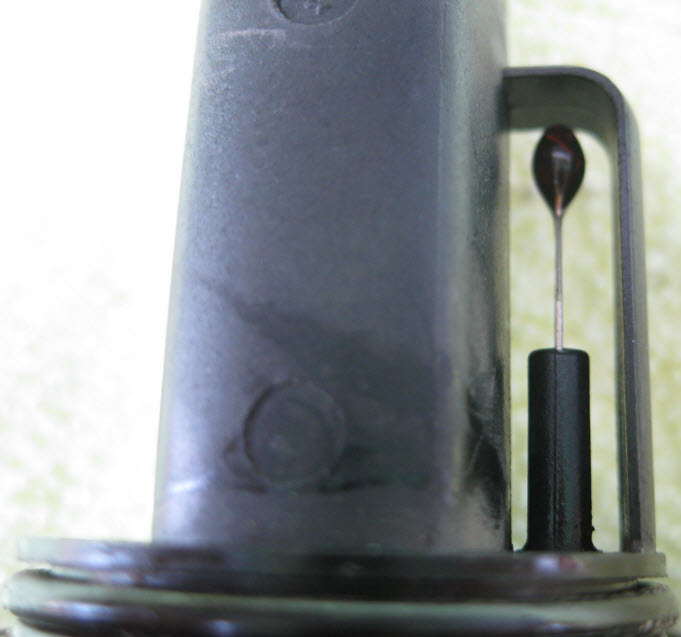

Hello All,
I am a mechanical newbie, so bear with me. My check engine light came on and the error was running too lean bank 1. So, doing a little Googling and found a dirty MAF *could* cause this. So I found some good directions and cleaned it. The thing was pretty dirty and I was very careful not to exert much pressure on it using a qtip. I mostly used MAF cleaner to do the dirty work. Anyways, here are the before and after pics. Is the "bulb" like tip supposed to stay so black?
Attached Thumbnails What should a Clean MAF sensor look like?-img_0916_small.jpg   What should a Clean MAF sensor look like?-img_0918_small.jpg

Yep that's good! Looks much better. My tip has never been clear, no matter how much I spray it. AFAIK the little wires are what do the sensing. Did you clean the other set of wires too?

Ummm I guess not. Where are the other wires? I sprayed a little down the plastic shaft.

They are down in one of the plastic shafts, they are hard to see, I can't remember off the top of my head where they are, but they are there, look down the shafts in good light and you should see them

That's not the critical part of the MAF.
You have to look down the tube for the real platinum wires that need to be cleaned.

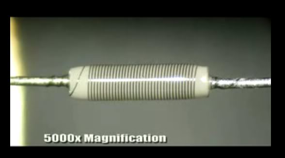

After I cleaned my MAF, I did some research and found out why it is a dumb thing to do to scrub your MAF wire with a Q-tip. This is what I was scrubbing:
Size:  13.4 KB (Photo courtesy of a K&N video on YouTube)
How I didn't break the wire is beyond me. I won't be touching my MAF wires anymore with anything other than a jet of MAF cleaner.
Old Feb 28, 2010 | 08:56 PM
shaxs's Avatar
Joined: Feb 2010
Posts: 21
Well, looks like I will be taking this out again. Maybe I will try replacing the antenna and doing this in one day
