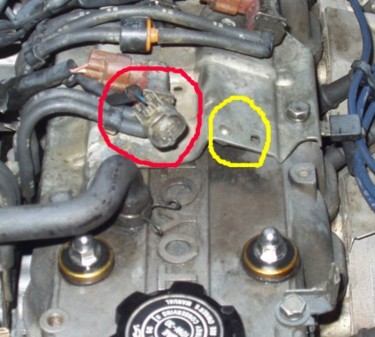

I think I'm missing a sensor on my 93 22re pickup...What is it?

might just be an extra plug. I will check the manual I have tomorrow.

HUH,You are missing a sensor.
Not sure of it's function w/ out looking into it. But, you will have 2 vacume hosess coming off of it and there is a breather on the end to regulate vacume for one reason or another.
Not sure of it's function right this sec.

do you have AC? I think that is where the VSV for AC is.

Yes I have A/C

Ok I looked at my truck and that is indeed the connector, for the VSV for AC connector. There is a vacum switch that connects to it, just like the other 2 on that plate. It connects to the AC idle up adjuster screw that islocated on the upper intake plenum (the thing with the big black or white adjuster screw).

ok so I should need it since I have A/C any pics?
