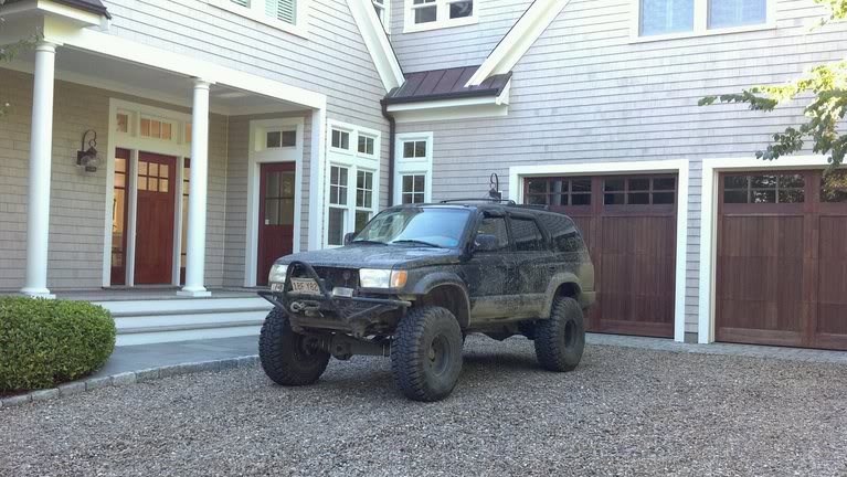

you cant really wheel with 35's on stock IFS. you need to just solid axle swap 2 clear 35's and look good.
That is a bold statement. And your concern with "looking good on 35"s " leads me to believe you don't know all that much about what it means to wheel.
Shoot my truck made cover of an off road Toyota driver mag sitting on 35's with IFS.

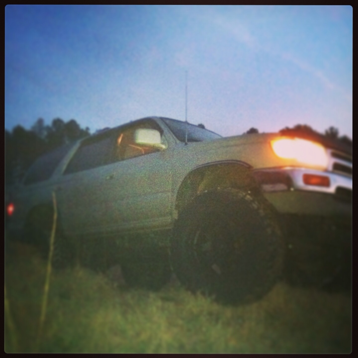

A little late on this post but reading these posts about 35's not fitting on a 3rd gen with ifs and the fact it would only be a pavement queen... Hate to be rude but y'all are wrong they will fit yea takes a little bit of work! 3" Toytec Suspension lift 2" Toytec body lift 1" dif drop 18x9 rims and 285/75-18's!!! And it's 100% useable drove over our motocross track hills today in 2wd no rubbing!
Ohhh the awkward moment when a girl can makes your "impossible" happen!
They said I would never be able to fit 38's on a 2nd gen with ifs either... Ohh but I did, And it wasn't a pavement queen either!
Sorry if u take offense to this post!What inch lift will clear 35s on 3rd gen 4Runner?-image.jpg
