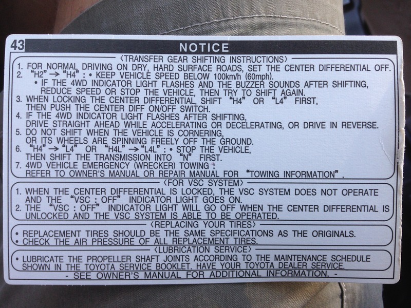

I'm looking for the little card that goes in the driver's side sun visor for a 4Runner SR5 Sport. I'm guessing it was supposed to have info on the 4wd system. I have an automatic with the push-button 4H, lever-actuated 4L, and electronic center differential. Can anybody send me a picture or a scan so I can print it out and have one for my truck?

I don't have an image, but I know where you can get one for a few bucks. (2001-2002 there was only one option for 4wd drivetrain, so only one card for those years.)
