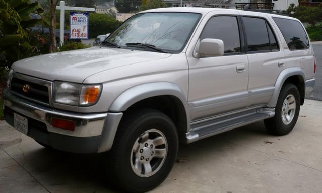

I did this mod on my 96 Limited for under a thousand dollars with new 231mm brembo rotors, pads, stainless steel lines, and an almost brand new set of 17 in wheels off of a new FJ. Absolutely worth the money, and the FJ wheels have more than enough room for the big calipers.
