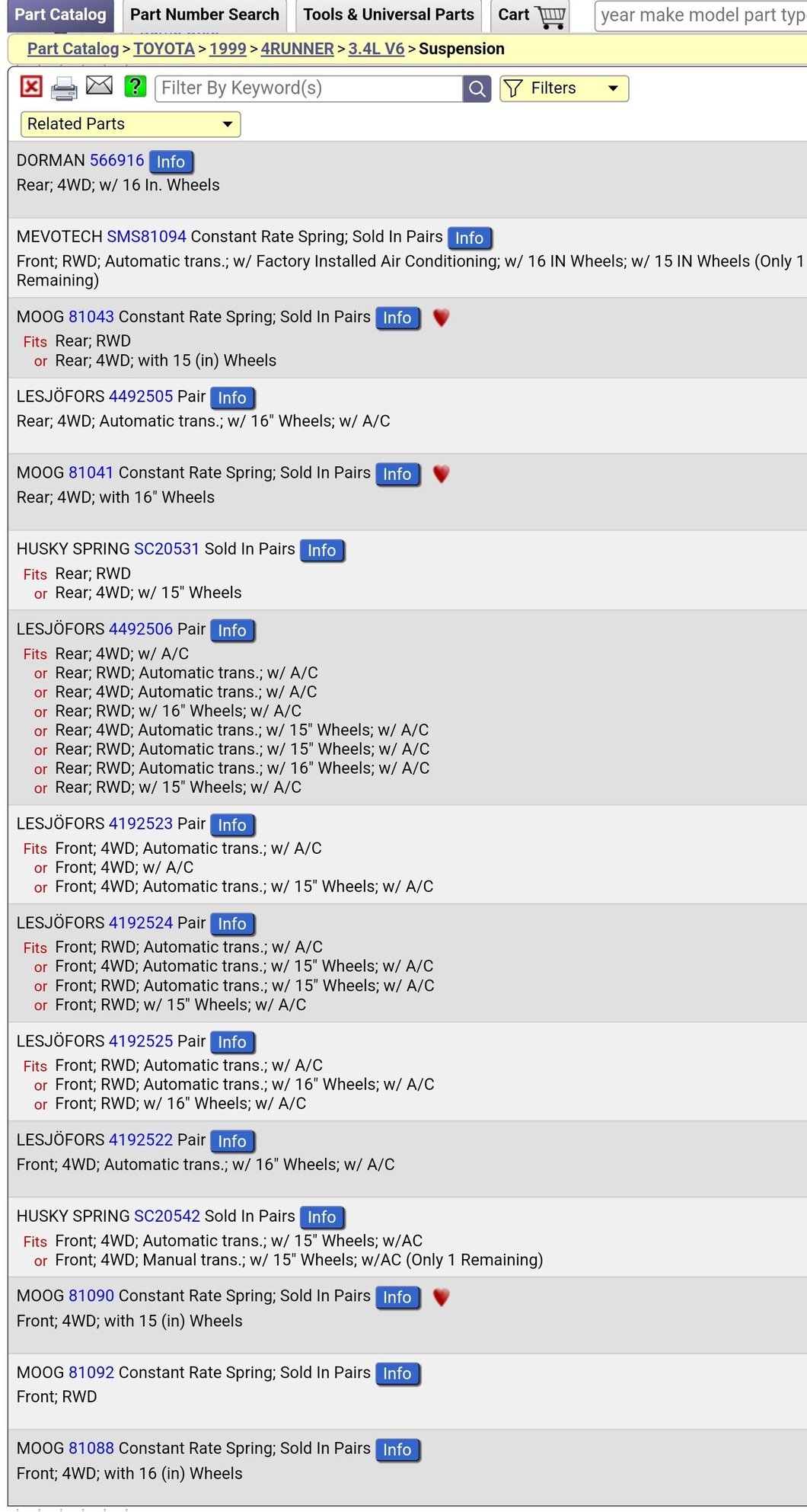

Hello, I am hoping for some guidence here. I have been running an OME setup front and rear for nearly 20 years on my '99, great suspension, never had an issue in over 150k miles. I am now approaching 70 years old and need something a little softer. Can't find stock front springs, OEM's are discontinued. Anyone have any ideas on how to get close to stock, ride and height, without breaking the bank (<$1000.) Thx for the help.

Look into the Moog springs on rockauto.com
81088 for the front
81041 for the rear
These springs are stock hight for a 99 4runner "highlander edition" with 16" wheels which is 1" taller than the other 4wd springs.
These are what I put on my 99 2wd and it rides good and isnt too tall. I paired them with some KYB gas adjust shocks

Robert, just got on Rockauto and could only see Husky, Dorman aor Dayton, no Moog. Where are you seeing that, even a search for "Moog" turns uo nothing. Thx.

These are for a 4runner. If you have a Tacoma, it will be different and I don't know what springs you would use
