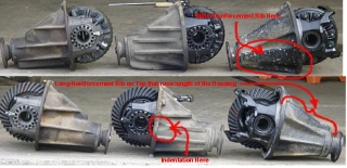

I'm still not convinced I have the standard 8" diff. Below are some pics I gleaned from this website:
http://home.4x4wire.com/erik/diffs/
My diff most closely resembles the diff on the right, which is supposed to be a T100/Tundra 8" diff. However mine also has the bolt head recess in the side of the middle diff in the picture above.
In the frontal view above My diff most closely resembles the T100/Tundra one, but it does not have the little "do-hicky" in the casting at the top center reinforcement rib of the housing as shown. Mine is flat with a slight rib running down the center of that wide center reinforcement rib.
My diff also has the wide reinforcement rib on it's side in a similar location to the diff on the right. Note that the diff in the middle pic has no wide reinforcement rib on the side, instead, they are all narrow ribs
Bottom line, my diff looks much closer to the diff on the right than the center diff, (which is supposed to be the V6-Turbo for the 4Runner). But it is not exactly the same.
Now you can see why this is sooo confusing...
All I can say for sure now is that my diff is NOT any one of these.
Remember my diff is on a 2000 4Runner Ltd 2WD, Information plate: VZN180L-GKPZKA, and A/TM A03A
VIN begins with:JT3xxxx
Thanks

I have a 4wd v6 auto and this subject has confused me a great deal as well, I looked at my 3rd a while back and compared to the pictures and mine didn't look like any of the 3 diffs pictured that you are confused with Radracer. When I ran the numbers off my door sticker those sites for the older models told me I had a 7.5" rear diff, Steve's site doesn't specify size of axle because he says they are all 8", and Steve's site also tells me I have either a 3.909, a 4.10 or a 4.30 with my numbers...I wish I could determine exactly what gear ratio and axle I have by looking at the door sticker numbers but I haven't any luck with a direct answer.

Kevin: I hope that you are right...but I have my doubts. See my earlier posts. I also talked to Randy's Ring an pinion, and he seemed to think the same thing based on my info codes. However, there are still many others that think that it is the 8" (p/n 913a321). Let us know if the 7 1/2" one works!
