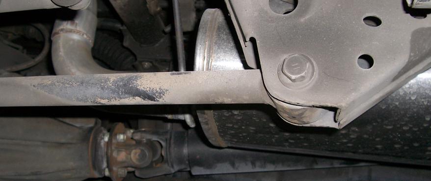

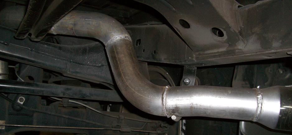

Originally Posted by aquasport17
Any chance you have some pictures of how yours came out?
Mandrel bent stainless steel elbows were used.
In the last picture, the pipe was widened to fit over the other snug.
On the cat side of the muffler, I instructed the shop not to mess with the stock O2 sensor bung and so they welded the 2.5" pipe over the stock 2.25" pipe - not pictured.
