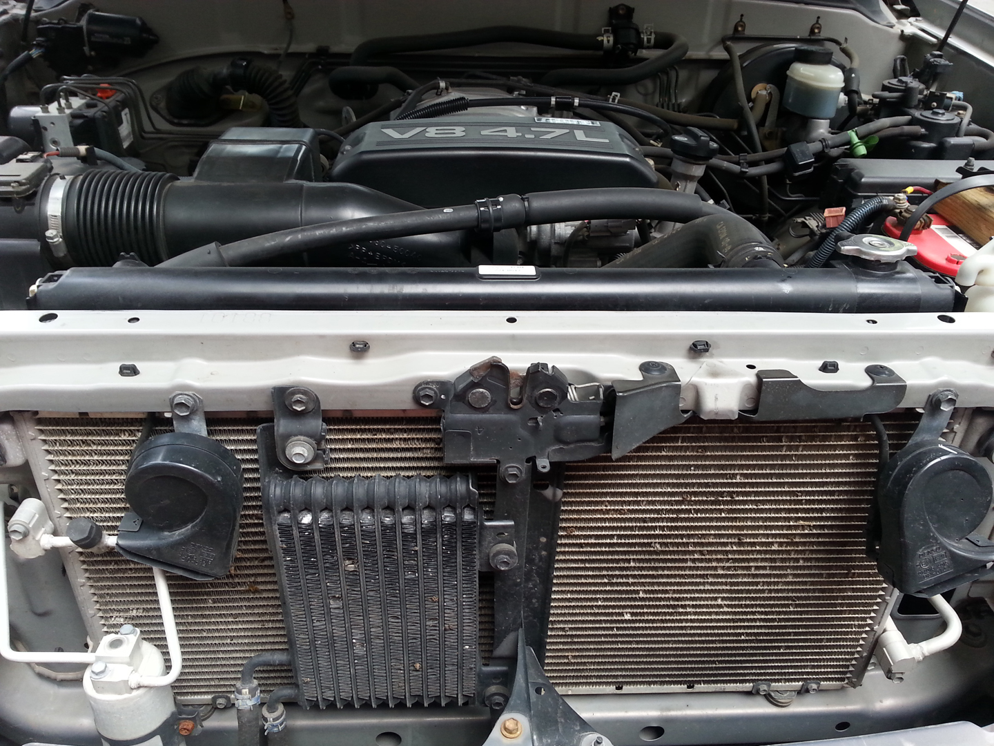

It seems like the general consensus is definitely to upgrade the tranny cooler. For starters, is the vertical rectangle on the left the stock tranny cooler?
Can I buy a tranny cooler that won't need modification and will just bolt in without any new hoses or anything?

Interesting, was not aware that the tundra came with a factory cooler.
Well that might do it but larger is always better. There is room on the other side for another one and the hoses are within easy reach. Or just leave it alone and watch the trans temp with an OBDII scanner.
If you are wanting to learn to work on cars, installing a tranny cooler is one of the easier jobs to learn with. You just buy one that fits the spot you want. Stick it in the spot, shove the radiator mounts through the holes and radiator and cap them off. Then run the hoses.
But like I said, if you watch the temp, it should make it as is.
I would ask this in the tundra section to see what guys with direct experience say.

You should be good with that cooler, still get something you can watch the temps with.
Also is that a 2x4 holding your battery down??

Check out TundraSolutions.com if you need more info. There aren't many Tundra owners on YotaTech.
Also, there is a "trans temp" light in the gauges if the temperature gets too hot!

True. I don't know anything about it since I don't tow with my Tundra. They have the normal radiator cooler, then a factory auxiliary cooler. And they are rated for around 6500 lbs if I'm not mistaken.
OP: early first gen Tundras are plagued by lower ball joints separating, transmissions eating themselves, front brakes being too small and the rear cross member where the spare is attached rusting away. Have all of those checked thoroughly before you make the trip!
