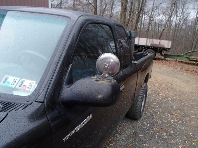

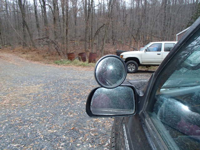

This is my 2000 Tacoma .
With well over a Million miles dragging things around these mirrors are not bad
I like being able to see
The spot mirrors allow you to see your trailer clearances coming around right turns.
If I thought I needed full West Coast Mirrors I would install them

Whoa. That's definitely not what I was expecting. Are they attached with some epoxy and screws, or what? I just have the little stick-on blind spot mirror on my driver side mirror.

The mirror brackets are attached to a piece of ABS flat bar with a M8x1.25 thread tapped .
This allows for easy replacement if one gets broke.
Then I used plastic weld epoxy to attach the ABS to the mirror .
Then caulked around the ABS with clear silicone which I use for all kinds of things
They are on now for 2 maybe 3 years with no problems
Since my Truck gets to major construction projects I get lots of comments about those mirrors.
I am so used to just using the side mirrors I just needed to be able to see better .
I would venture I use the spot mirrors for 90 % of checking the mirrors
Now granted I have always been a function before fancy type of person so some might find this quite ugly
The other option I was looking at was mounting them to the front fender I decided on the mounting on the mirror

Cool.
Well if you're regularly pulling a trailer and don't want to add true towing mirrors like some full-size trucks have, your setup is definitely better than the one's I linked. With those you'd be constantly having to take them off & back on again, which would get annoying.
