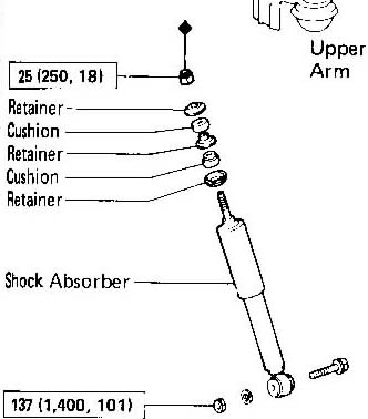

this might help...its from my 92 FSM....if its the wrong part lte me know i will scan something else (I scanned the whole page but it was too big)
Yeah thats for the shocks. I just swapped the bushings in my anti sway bar. And was wondering on the torque on them...
