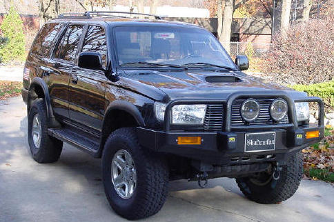

OK, now that "Lurch" has had his suspension upgraded, it was time for some new shoes.
Goodyear AT/S 285/75R16s, panhard drop bracket welded in place and an alignment done on Friday. It's getting close to being as done as it's going to be for awhile (see pic attached.)
The AT/Ss are an 8-ply tire with a maximum pressure rating of 65psi. When I picked up the truck after having the work done, I was told that they were inflated to 50psi (not used to hearing tire pressures that high!)
I immediately noted how "mushy" the handling was -- lots of sway that I'm not used to with this truck. It was disturbing. Felt kinda like driving around on nearly-flat tires. I checked the pressures when I got home and found them to be 43psi all the way around.
Knowing that the taller tires are going to be a bit mushier, it was more than I was willing to accept if not necessary. I increased the pressure to 50psi and it improved somewhat. I can live with it now.
However, since these are not the stock (recommended) tires and are entirely different in their rating and construction, how can I find out what pressures are acceptable with this tire on my truck? Lord knows, I don't need a blowout because of over-/underinflation!
The archives have lots of tire pressure recommendations for 265s, but I found scant little about 285s.
Anyone out there running the same tires and have some recommendations?
Thanks,
Don
