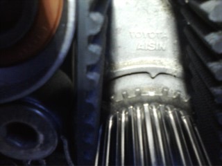

Problem solved. ToyotaDon and his co-workers nailed it. Crankshaft gear is missing a tooth. I decided to turn the crank and get pictures all the way around so I could show none of the teeth were damaged. Found it on the second picture.
I'm pretty happy right now. Nothing like confirmation of a problem. One more tear down and re-assembly and all should be good.
Thanks everyone - I'll keep you posted. Gotta try to locate a gear now. Hopefully there is one available locally.

Picture of the missing tooth.

A picture tells a thousand words.....glad you found it. Those teeth are pretty delicate, it seems.

Oh - and just for the record, the broken tooth is on the opposite side of the pulley from where I was prying.
