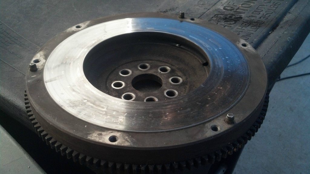

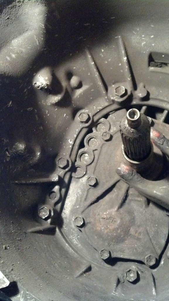

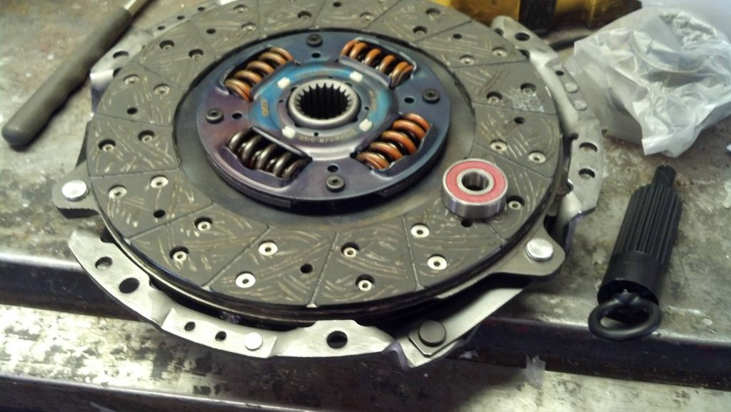

Got this done thanks to a family friend this weekend. Thanks Robert!
Found some interesting things. At one point, a pressure plate must have exploded. The inside of the bellhousing is scarred and there was a pressure plate finger in the bottom of the bellhousing, but the installed pressure plate was fine. When that happened, they must have pulled it apart just enough to replace the clutch and cover, but they never resurfaced the flywheel.
The clutch was glazed in parts and completely new in other spots. The flywheel is pitted/scarred, and really glazed, so the clutch disc wasn't necessarily at fault. We ended up buying a new flywheel. Napa pricematched O'Reilly, so I saved a few bucks there.
All said and done, the Exedy kit was very complete and seemed very good in quality compared to the parts house brand offerings.
