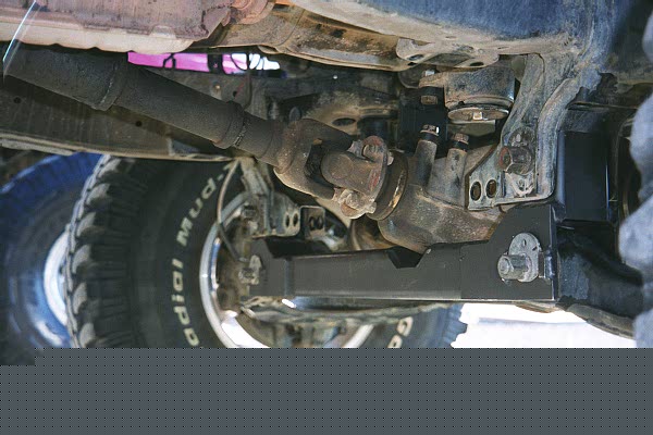

i just found a t100 pic with a passenger drop diff and transfercase. i dont know if its a automatic or what engine it has or what year but its a pic.
Attached Thumbnails t100 vs 3rd Gen 4runner tcase questions-t100liftrear2.jpg   t100 vs 3rd Gen 4runner tcase questions-t100lift1.jpg
