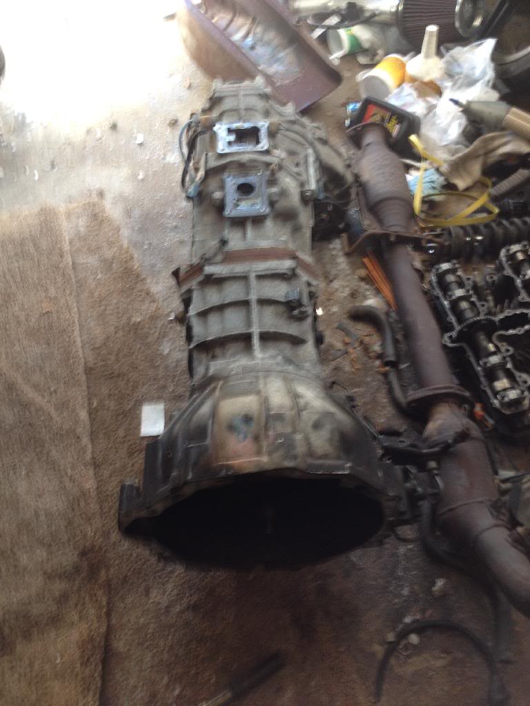

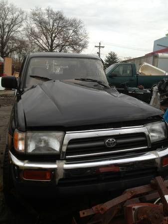

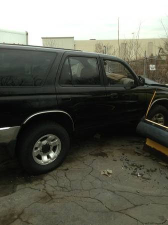

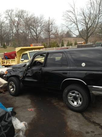

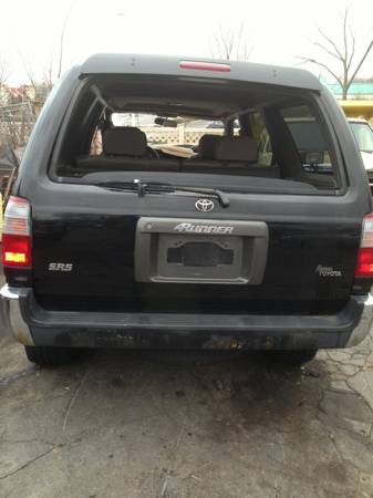

Pics because we all love pics, here is the donor.

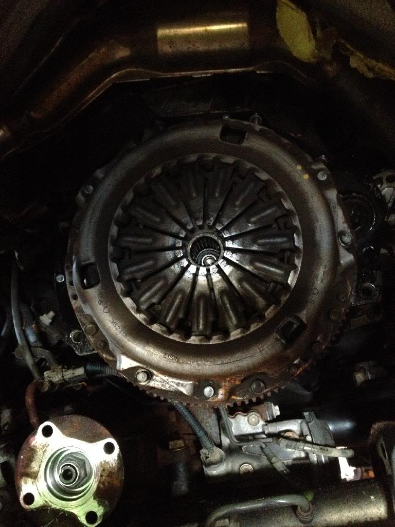

Success!!

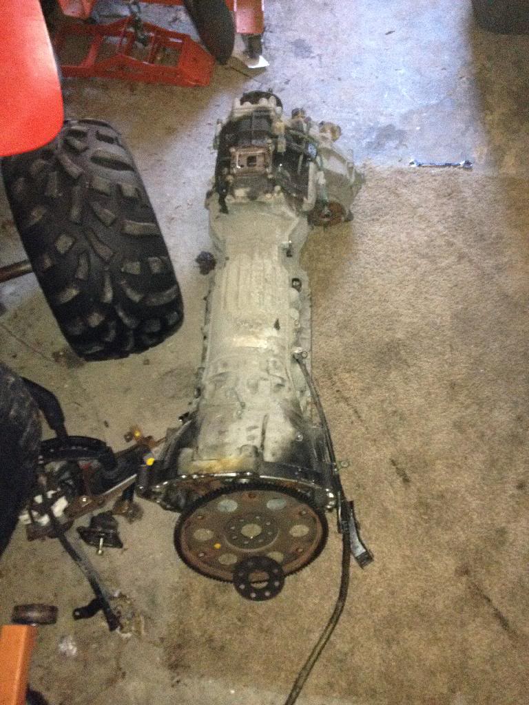

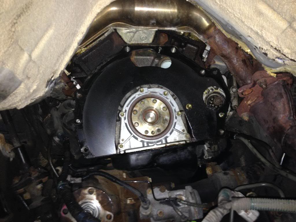

Auto trans is out!
Brake pedal is mounted, all that's left to do before I can throw the 5 speed back in is mount the clutch pedal, and master cylinder and the wiring!

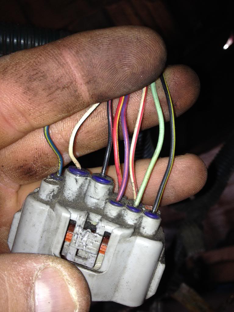

Here's my trans plug.
Looks like I have the following colors,
blue with a yellow stripe
white with a black stripe
black with a pink stripe
red with a yellow stripe
purple with a red stripe
white with a red stripe
green
black with a yellow stripe

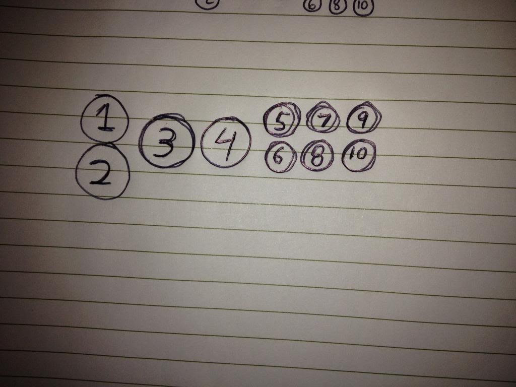

So here's a crude drawing of the layout of the plug, the numbers I have labeled the pin are for my reference.
So this is what i've gathered, correct me if the pin location is incorrect, I'm just trying to get an idea of what I need to do.
Me
1 blue w/yellow
2 not used
3 white w/black
4 black w/red
5 red w/yellow
6 purple w/red
7 white w/red
8 green
9 not used
10 black w/yellow
Therefore I would need to connect the following;
white w/black to black w/red (pin 3 to pin 4) for clutch depress
black w/yellow to red w/yellow (pin 10 to pin 5) for clutch release
black w/yellow to white w/red (pin 10 to pin 7) for reverse switch
I hope some of this makes sense?
