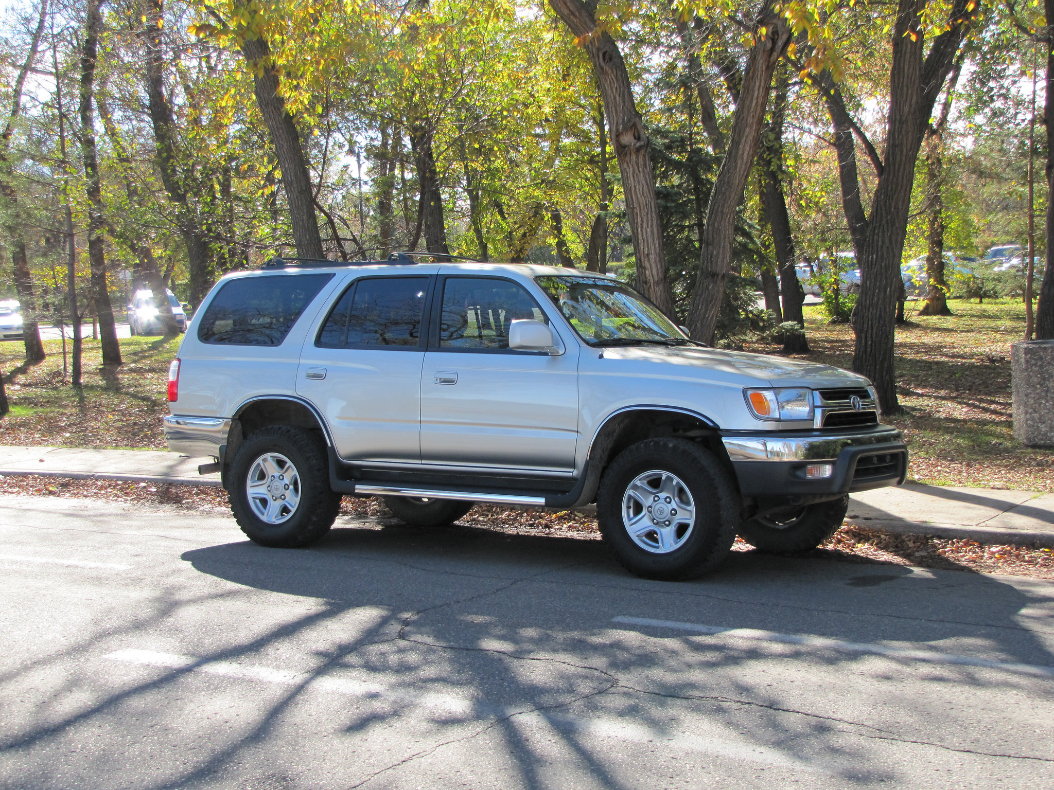

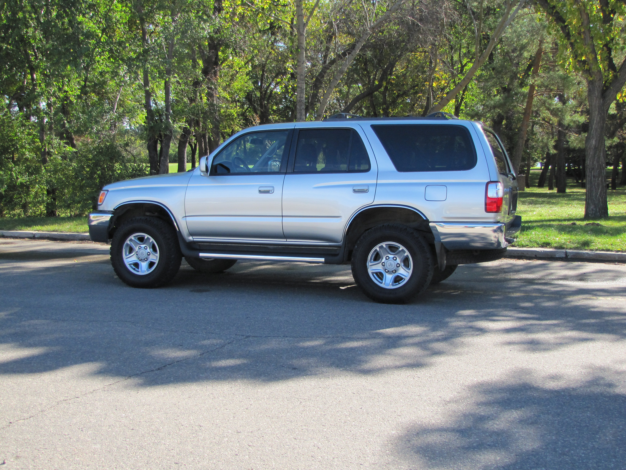

Well this fall I had a shock start to leak so I bought the Sonoran Steel 3.0 kit with 99 coils and 4600 bilstein shocks. Stiffer than stock but nicer on broken pavement. It definitely is up over where it used to sit. I am happy with my choice. You might do more wheeling than my daily driver so the height may not be enough for you. Stock tire size on for now. Hopefully this gives you a better idea if this is enough for you.
