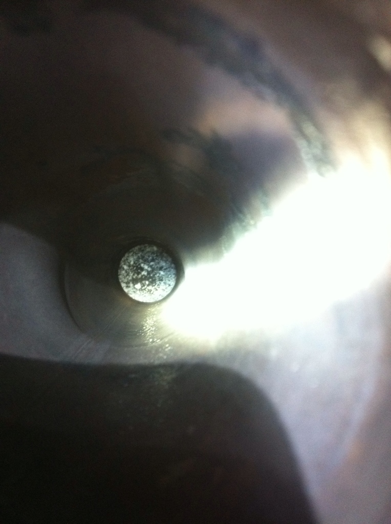

Ok so, on a separate hunch, I unbolted my exhaust after the first cat and slid it to the side. I unbolted here rather than before the first cat because it's only two bolts and the first cat also has the AF sensor bung as part of the same piece. This bypassed the secondary cat completely and the downstream O2. Aside from it being mind numbingly loud, my truck is running like an effing raped ape and I'm not feeling any surging. Granted it's difficult to feel anything with the exhaust as it is now, but holy piss it is pulling with more power than I've felt in a long time.
Can a plugged cat cause this?
Old Jan 22, 2013 | 10:48 PM
jberry813's Avatar
Joined: Jan 2013
Posts: 13
From: Lake Tahoe
Mystery solved!
The second cat was plugged up tighter than an asian virgian's ass. Pix below are all taken from the direction of exhaust flow. Notice the last picture which shows some light barely shining though. That was the brightest damn flashlight I have and you can barely see it.
After the test drive without the second cat I just gutted it completely and bolted it all back up. Truck ran fantastic after that and no more surging. Got back a ton of power that I thought I may of lost but was sure it was all in my head. Put my supercharger back on and it's running like a bat out of hell again. When I get some time tomorrow I'll drop the tank, but the larger fuel pump back in and go back to a smaller pulley, piggyback and 7th injector and be happy as a pig in shiet again.
Thanks for everyone's input, especially Texas_Ace.

Yep, that would do it.
That most likely happened due to skyrocketing EGT's due to either no extra fueling with the supercharger or a bad tune on the 7th injector.
Get a wideband and check the tune ASAP. EGT's that high are not good at all for anything.
You want AFR's in the 11's (11.8 being about ideal) the ENTIRE powerband at WOT. The tune that came with my URD was completely wrong and I had to start over from scratch to make it work.
