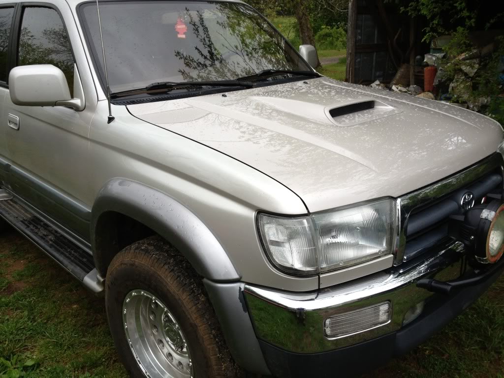

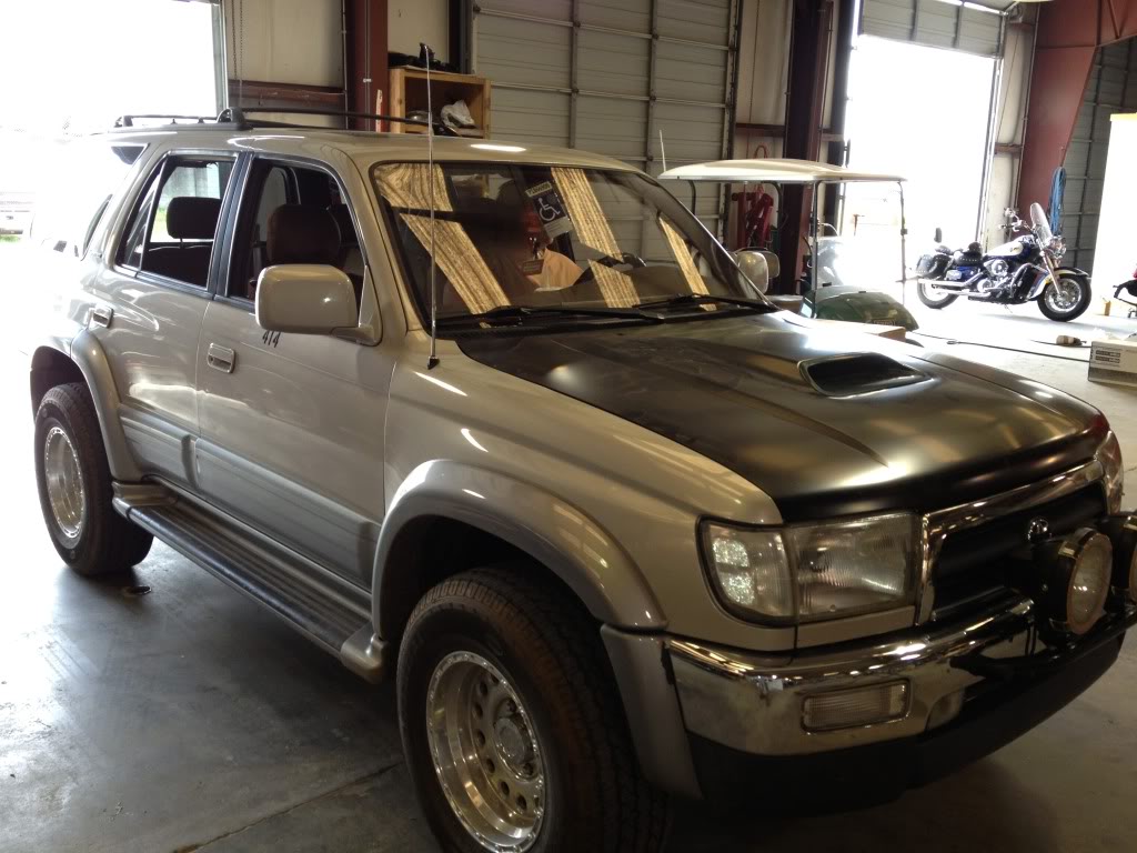

98 with aftermarket hood.

So the consensus is the aftermarket hood fits as well as an OEM?
