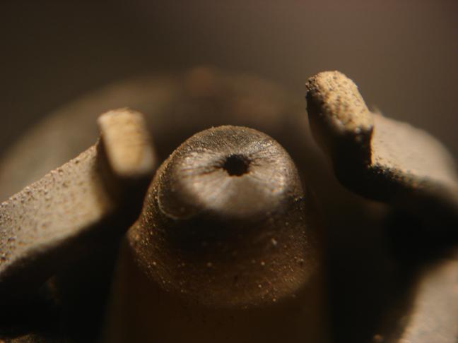

The real technical reason why Bosch Platinum or any platinum plugs are not good for the 4runner or Tacoma 5vzfe engine is that on the 5vzfe engine the ignition type is called a wasted spark ignition and the way it works is the 3 coils above the passenger side of the engine spark the plug below it and the opposing plug on the other side of the engine. One plug sparks on the compression stroke and the other on exhaust stroke hence "wasted spark". Anyway in order to spark 2 plugs simultaneously the coil sparks the plugs through a circuit where the current passes in a loop from the center electrode to the outer 2 prongs (4 for some Bosch plugs) through the engine to the opposing plug's outer prongs to the center electrode then back to the coil completing the circuit. This is a great electrical system except the sparkplugs used must be able to handle the spark jumping the other direction for the driver side of the engine. When I first bought my 4runner it had a rough idle and terrible acceleration so I checked the plugs and found this on the passenger side of the engine Spark Plug are they worth it or dont bother-spark-plug.jpg. The plugs looked fine but then I pulled out the plugs on the driver side and found this Spark Plug are they worth it or dont bother-sparkplug.jpg. As you can see the platinum is gone due to the spark jumping the opposite direction (the Bosch platinum 4 is the same as the pic but with 2 more prongs). Now I don't know what the direction of the current is to determine weather the platinum is being zapped out of the ceramic surrounding or if it being welded to the outer prongs like an arc welder. All I know is that the stock Denso or NGK plugs are designed to handle this kind of application because they don't have platinum. Platinum is too soft of a metal to handle the backwards spark.
