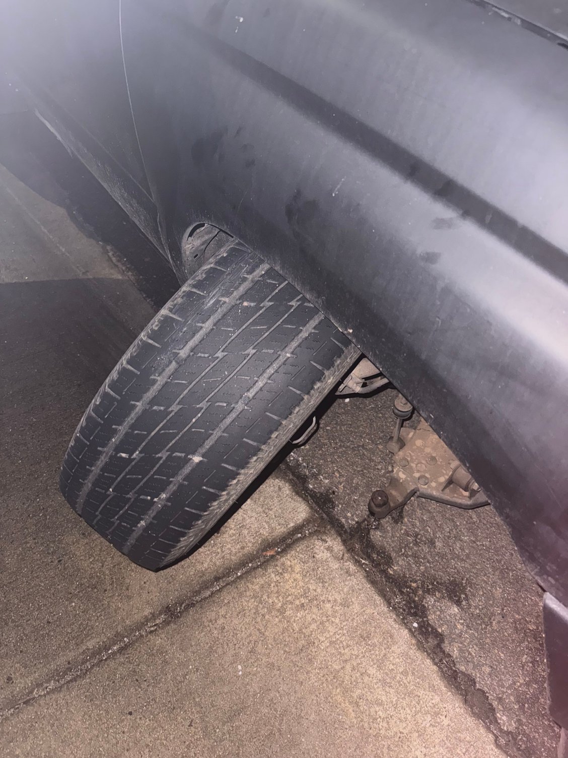

Son’s 98 2WD broke at the ball joint

Ugh. This won’t be fun trying to fix. Probably going to let a shop handle this. Currently at just over 259k miles.

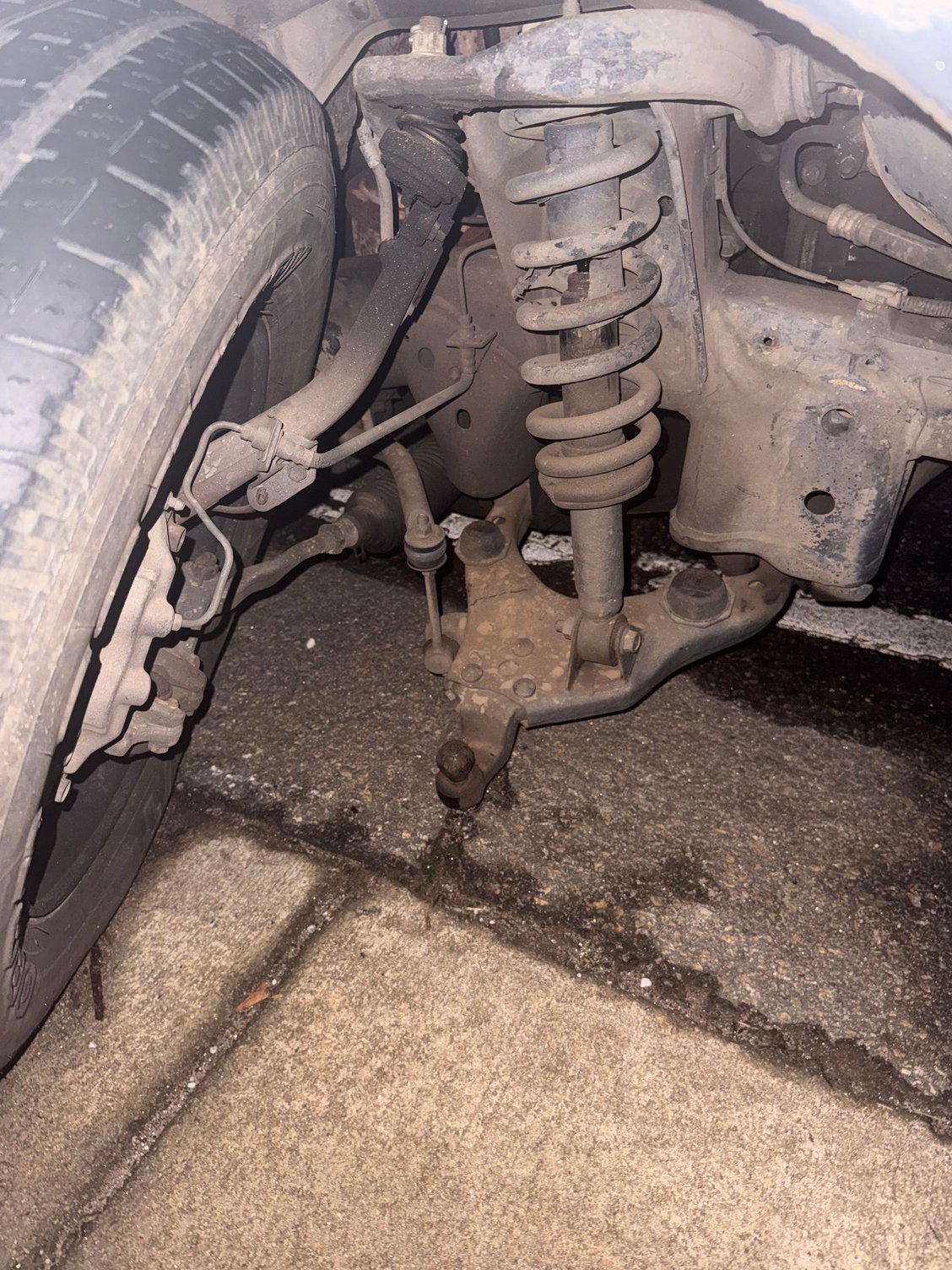

Just out of curiosity, how many miles on that ball joint?
They're not weak, underspecced, or overstressed, they just have a catastrophic failure mode since the weight of the truck is pulling the ball out of the cup. You can't let them get worn out.

The shop replaced both sides. Amazingly, only the ball joints themselves needed to be replaced, and an alignment was then done.

I think it has just over 260K miles in the chassis. He just bought the truck fun a coworker, who said they were done about two years ago.

Oof, you can see by the pic that it was a ball coming out of the socket failure, not a loose or broken bolt issue (either the large single bolt on one side, or the 4 smaller bolts on the other).
General consensus is to only use OEM Toyota balljoints, not cheaper parts from parts stores. People have had premature failures from cheaper aftermarket parts, and this is one place where you don't want to try to save a few bucks.
