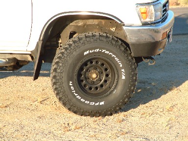

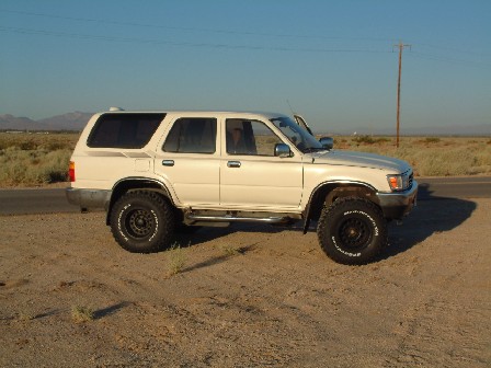

Well last week I installed a 2" body lift last weekend and I got my rims back from the powder coater Friday and had my BFG 33x10.5 MT's put on ... pix. It is deffinitely looking better after rescuing it from my girlfriends backyard.
