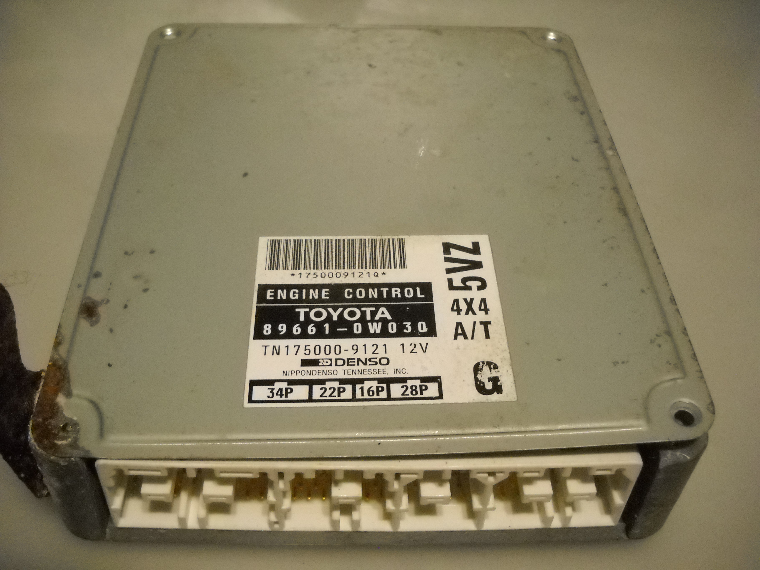

I just got home where my EWDs are and such. Here is the terms used in the EWD, pin differences etc.
1997 Auto T100 3.4L ECU pin A18, signal SDL which goes to OBD2 pin 2 (tested working with my scangauge 2)
1998 MT T100 3.4L ECU pin A8, signal SIL which goes to OBD2 pin 7
The ECU is easy to get to in my T100 since there is a fender rust hole that the last owner claims caused the last ECU to fail (internally it looked great). Currently have the hole patched since I'm using the truck and haven't even put the glove box back in from checking the fuel relay (COR I think is the correct term). I have some packages to get ready, even though USPS is closed today. I'll try to get photos of the ECU internals. The MT housing is a bit different from the AT other other ECU's I've pulled from Toyota in general.
.. Clipped
Obd2 pins..
Short version inconclusive..
#2 is j1850(sae), #7 is 9141-2 (ISO) known as K-Line
both could be running at 10400 baud, however j1850 can run at 41.6k also depending on the switching protocol..
The generic 8051 will run at megabit signaling speeds(I have very ancient network cards that run these from back in the xt/at/286 era for example). The Toshiba x8 is based on the 8051..
​​​​​​​Regarding housing difference, they wanted to keep the same basic profile and went to a two board circuit where the second board stacks on top of the other.

Forgot to mention the 98 was a reman denso, I'd assume it's oem toyota that's been repaired but not sure.
For better google results, the PCM/ECUs are part numbers 89661-34342-84 for the 98 and 89661-0W030 for the 97. Both are 4x4 and for the 5vz, only two differences is the year difference and MT vs AT.
Kind of interesting the reman denso (japan) is the bad one while the good ones is Denso TN.
Anyway, giving a shot of uploading pics. The 97 I couldn't get all the screws out so I couldn't get a back side of the board, but there is a clear difference. Appears the 97 is a single chipset, while the 98 has missing spots where it looks like a 2nd chip set could have gone instead, maybe some sort of conversion year?
First 3 photos are of the 98 MT and the last 2 photos are of the 97 AT which looks like 90% of the other ECU's I've pulled from this era of toyota (cars and trucks). THe 97 board is around an inch longer, and both are only a single board.
If there is a chip you can't read the numbers on, let me know and I'll try to read it. I have quite good close up vision. Beware people scared of spiders, the last photo has one on the right side lol.
EDIT, the 2nd photo makes the HC401 black box appear cracked, it isn't, it's just how the camera picked up the silicone/epoxy line.

Looks like we have a good example of the Toyota JIT process. (JIT uses local manufacturing, the closer the better ECT..)
Your 97 ECU from ND Tennessee differs from the other example on the Toyota ECU wiki.

Interesting, the board numbers are very similar, mine is prefixed TN, and the last 4 numbers are completely different though. I looked at the 98 ecu on the wiki and noticed it was a bit different too. I guess the main bulk of the number must be part type or something similar which is quite close to how I understand Honda part numbers, something like xxx-yyy-zzzz where xxx is part type/location, yyy seems to be source application for the design, and zzzz is the actual number to reference that exact part. If YYY is 000 then it's a universal type of fit (most bolts etc).
There seems to be a ton of ecu part numbers for the 5vz. From my understanding the 98 pickup was sold new in northern Michigan where I picked it up since it has the dealership tag painted on the tail gate and appears to be old. Both the 97 and 98 trucks didn't have EGR valves encase another ecu part number would be handy for those trying to do a 3.4L swap and pass SMOG.
