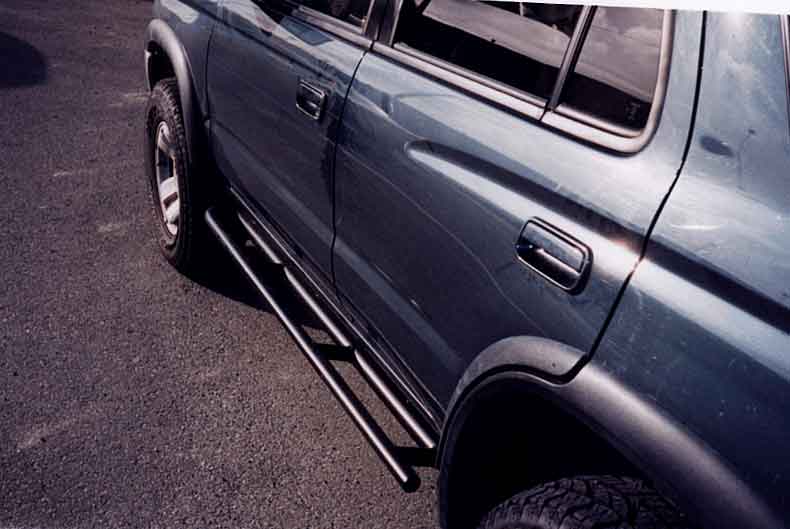

Here are mine right after I got them installed:
https://www.yotatech.com/attachment.php?postid=68231

From: Deep Gap, NC
Very nice David! I'm planning to test them this next weekend, so we'll see how they do.
