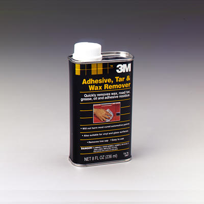

To remove, tt would hellp to heat up the pieces with a hairdryer before you pull. This will make them less brittle when you pull them off. Take your time when prying it off. There will be some adheasive residue that comes off easily if you rub it with your thumb. It will probably take you about an hour to remove the old kit. You just have to be very careful and remove small sections at a time. You can also use 3m adhesive cleaner.
It will not affect the Oak or Gray areas, but does dissolve the black color, so you have to be careful to only apply it to areas you know you will recover with a new trim. Then you want to go over everything with the isoproply alcohol. Then put on the new adheasive promoter included in the new dash kit.
