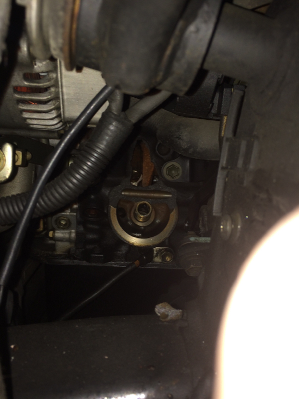

Yesterday I got a smoking deal on an 03 Tacoma TRD. It just happens to have a hole in the block. I bought it after looking at just two pictures and knowing the block was toast. After getting the keys, I drove over to check it out. The truck has 165k on it and by the notes in the owners manual looks to be meticulously maintained up till about 110k. After looking at the golden brown oil on the dipstick that stopped just short of the full line, we started looking for the hole. Immediately I noticed there was no oil filter from underneath but could not find any traces of oil splatters, drips, or puddles. Then we saw the hole. I haven't got it to my house to look at it yet but was curious about thoughts on this hole.

Has the engine been running without an oil filter?? If I see the hole in the block it looks like it slung a rod.

I know nothing about the truck other than it got towed to where it's at and the records. My assumption it the filter got taken off while someone was looking at it. I'm more curious as to why there wouldn't be any oil sprayed throughout the engine bay.

Oil could have been poured in after it slung a rod.

That would be my assumption too. But you can see that it's not brand new. I could very well be wrong, wouldn't be the first time. So next move, motor. What do you all think? Junk yard, short block,long block, "Jdm"? Truck has 165k on it.

Pull the current engine and see what happen. Then it's up to you, go back to the same engine or prefect chance for an engine swap.
