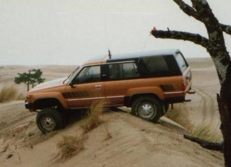

No, on 84-89 it doesn't. See the brackets in this pic. It mounts to the frame with brackets just like the truck bumper does. I tore my stock one up the first hunting season. So I got a piece of 3x4 1.4" wall box steel and modified the stock plastic end caps and made one that lasted forever, yet looked stock. Welded a receiver hitch to it, made brackets out of 5/8" plate. Bullet proof.

Yeah, I couldn't have told you the years, but I knew there were both. I had frame brackets when I went to have Schaeffer fab up mine. If you have the brackets, hang on to them. I put a BL on mine after the bumper was made and we looked into getting new ones to make an adjustment to move the bumper in tighter to the body. Thought they were going to be $20 but turned out to be $100. Needless to say we're going to cut up the ones I've got.
