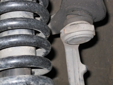

Hey, i recently put a 3 inch spacer kit on my 02 tacoma prerunner and now whenever i hit a speed bump kinda fast my front radius arm will hit the coil. I can see exactly where it is. Do i need to get a wider upper control arm?
-the left and middle photo is the coil decompressed
-the right photo is compressed
i was thinking i might need a wider upper and lower comtrol arm? please let me know, i only used these spacers because my tires were rubbing on the inside of my fenderwell.

you need to take that spacer out, its over flexing your suspension

you could also install limited straps to prevent too much downtravel. i believe a prerunner is 2wd , so you dont have to worry about cv's.

I'm not sure what you are calling a "radius arm".
Is it rubbing a little or a lot? If it's a little, it may not be a problem. Would a 1/4 wheel spacer help?
Pictures?

i just put some pictures up.. hope that helps

Something ain't right, sorry to say.
Looks like full droop is causing the upper a-arm to contact your coil?
Is your spacer really 3"?
I think you added too much lift...post pictures of your CV angles, etc. Did you get an alignment too? Alignment may help a tad. But, you're just going to have premature wear on all your components.

That is a ton of droop to come in contact. I'll have to see where mine are when drooped.
The difference between mine and yours would be... my lift is with taller coils and yours is a spacer. The spacer goes on top of the shock/coil plate (correct me if I'm wrong). a lift like mine keeps the stock droop and since your lift lowered the shock plate it will allow the wheel to droop that amount. Since you have a 2wd you don't have to worry about over extending the CVs. Does it hit a lot? If just once in a while it probably isn't a big deal.

the spacer only measures 1.5 inches and it raised the front 3 inches. had an alignment done also. the spacer is mounted on top of the coil. it doesnt hit a lot but i just have to be careful when i go over speed bumps, like a lowrider : ( i dont know what else to do other than buying a new coilover with 2.5 inch lift..

This is a close up of where the coil is coming into contact. Its about 3/4 inch and it chipped the paint. Will this cause major issues in the future?

I think that much lift completely on top of your strut assembly is the problem. Most spacer kits have one (1-1.5") spacer inside the assy and another on top (1-1.5"). Crolison is right, it's over-flexing your suspension.

I'm really not sure why you get 3" of lift out of a 1.5" spacer, but the overall geometry is being pushed to the limit. I guess it's just another reason why people say spacer lifts suck. Are those stock shocks?

There's a small tooth of metal on the top of the steering knuckle (that's the part you're talking about) and you can grind it off. That will probably take care of the problem - I had the same thing on my 4R when I put the Tundra swap on, and I ground the tooth off before it attacked my pretty new springs.
The Tundra springs are wider than the 4Runner springs which is why there was contact, but I don't know how they compare to the Taco coils. The spacer you're using might shift the spring out a little.
