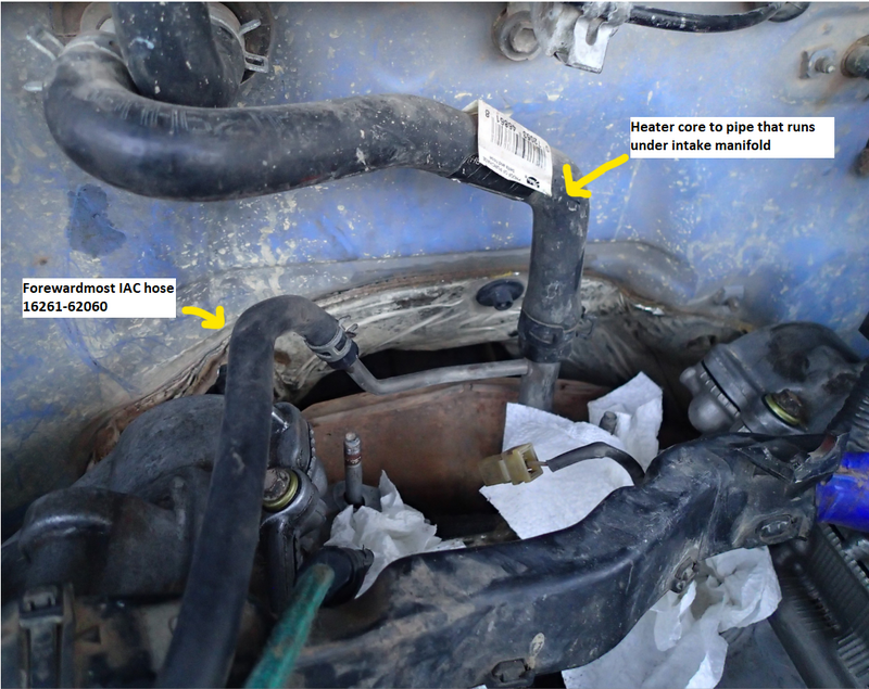

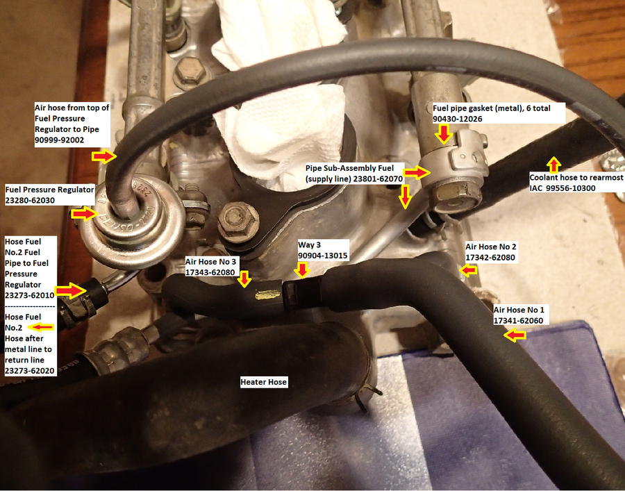

Could it be when you pulled the coolant hose off the throttle body? You'd think there'd be evidence of leakage if it were the gaskets. Otherwise not much coolant-related hoses there, except heater and the ones to the iac under the tb...
Attachment 208380
Attachment 208381
Not pictured- the forward IAC coolant hose to pipe (not attached to intake manifold but to the pipe behind it)- part# 16261-62060
There's also the coolant temp sensor up front.
