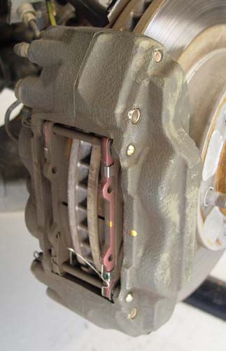

Yep, you guessed it. This is a shot looking from back to front.
Looking at all thes you will see why brushing while still mounted would be the way to go. If you are confident (unlike myself) in removing and dissassembling the calipers, then I think spraying would be the ideal way to go and get a perfect coverage of paint.
One of the places I went to yesterday l;ooking for the paint said they would take them off, paint and reassemble for around $150.........nope. This is too easy of a project to do that.
Let me know what you guys are planning on doing.
