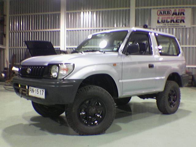

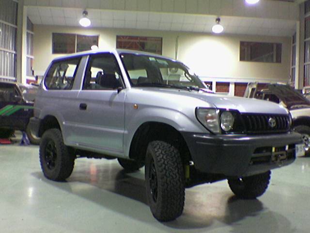

Just installed my OME suspension today. Got a nifty 2.5 inches of lift, and increased ground clearance with 275/70R16 BFG ATs. The Prado's ride is a lot better now, with significantly less body roll than i had with the worn out original suspension. Excuse the crappy cell phone photos, more photos to come on Monday after i test it off road.
This is the setup I ended up getting:
OME 881 front
OME 891 rear
N91 front
N86 rear
Attached Thumbnails OME kit opinions-image-536-.jpg   OME kit opinions-image-537-.jpg
