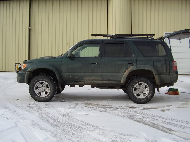

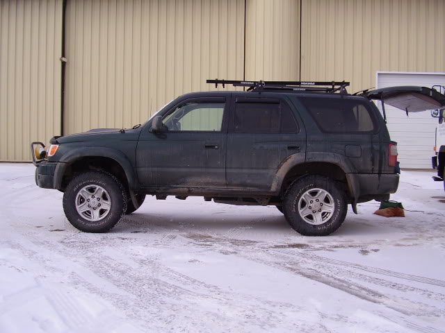

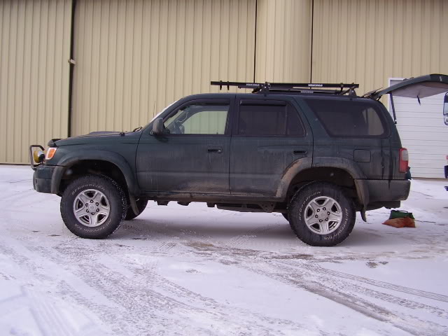

I took some pictures. They arn't pretty but that's not what were looking at. Just a reminder, I have Tundra TRDs up front and OME 890s out back. I don't have any extra spacers, just the springs for lift.All measurements were made from the bottom of the flair to the center of my wheel cap. Unloaded the measurement was: Front 22.25" ,Rear 23". All other measurements will reflect a drop or rise from these measurements. I added 35# sandbags to my rear bumper for weight. This was as close as I could get to hitch weight.
Unloaded the measurement was: Front 22.25", Rear 23".
Loaded with +210 lbs: Front no change, Rear drop of .5"
Loaded with +315 lbs: Front rise of .25", Rear drop of .75"
Loaded with +420 lbs: Front rise of .25", Rear drop of .1.25"

Loaded with +560 lbs: Front rise of .5", Rear drop of 1.75"

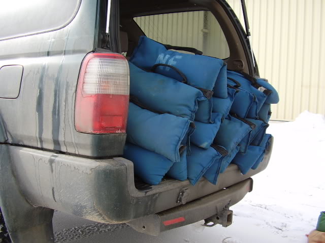

This is 560 lbs of sandbags. This is the placement for this test.
