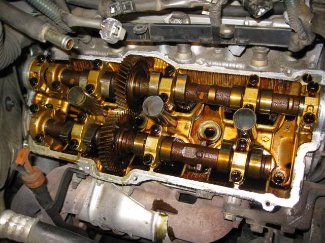

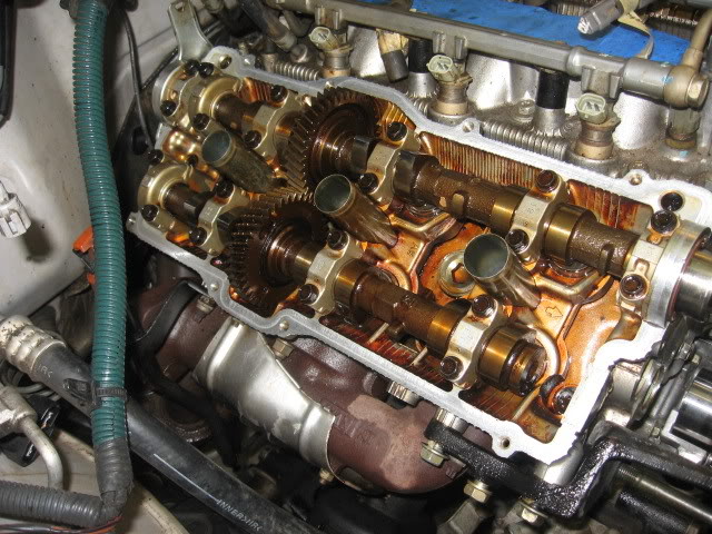

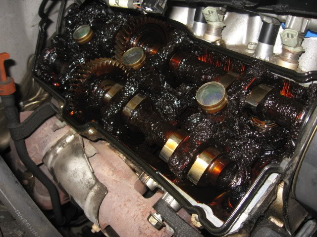

Sludgie Update with Pics
Gents,
Jon's Runner is still going strong with the supercharger. Recently it developed some valve ticking on the passenger side. So, last Friday we pulled the passenger side valve cover to measure the valve clearances. We ended up replacing 3 shims and swapped two of those three to other valves. All five were exhaust valves that had too much clearance. No more ticking, solved that problem pretty easily.
It was the first time that we had popped a valve cover since the engine slug saga years back. Below are pics of the passenger side valve cover on Friday night, another from after the cleaning job, and another of the sludge as we found it. Jon has been changing his oil with Mobil 1 synthetic and we have kept up on the PCV maintenance.
Pic from Friday night, no sludge, nice tan color:

Pic of what it was like when we buttoned it up years back, after cleaning with #2 diesel and a shop vac:

Pic of what it looked like when we pulled the valve cover and found the sludge during a valve cover gasket and timing belt change:
