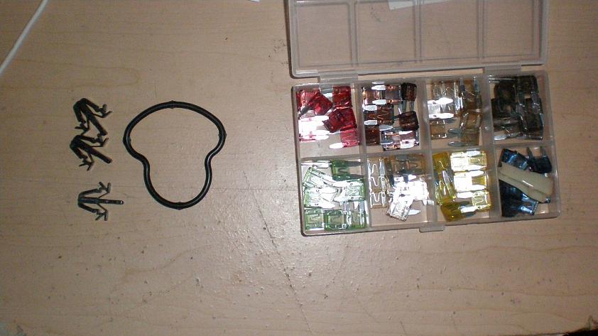

I just went to Power Toyota Irvine and I got both the oval and the o-ring.
The oval im sure is whats leaking but for a few bucks, worth doing both. I'm waiting for the o-ring to arrive tomorrow and I have the oval already. I had to get the diagram and I got your last reply about the same time.
So yeah, you were right about the gaskets. I'm gonna do it all when I get the new sway bar bushings in.
Thanks again.
Here's the diagram and also my invoice with part numbers...
I also got extra grille clips in case, and a fuse kit with 80 fuses for 10 bucks, score!
