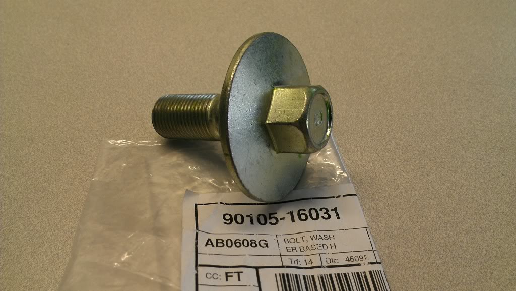

nice, just about to start this job myself so all the info helps. one thing to maybe make a note of; the part number for the crank pulley bolt you listed is for 09/1998 (model year 99+) on. there is a different part number for the 11/1995-09/1998 (96-98) models, 90105-16031. not sure what the difference is but thats the number i got for my 98 from the dealer and i confirmed it on toyotapartszone.com.

Old 02-07-2012, 11:48 AM
spokane.yota.man's Avatar
Join Date: Apr 2008
Location: Spokane, WA
Posts: 238
Received 0 Likes on 0 Posts
Originally Posted by skjos
Is everything else except the crankshaft pulley bolt the same for earlier years of the 5VZ-FE?
i don't know about the hoses or the timing cover gasket, all the rest appears to be the same. here is a picture of the bolt for my 98. anyone know the difference or have a picture of the 99+?

Old 02-07-2012, 02:17 PM
TheDurk's Avatar
Join Date: Feb 2007
Location: New Jersey and Sao Paulo
Posts: 1,262
Received 1 Like on 1 Post
Well, just from looking, it appears that the bolt in the picture does not have the pre-applied thread-locker compound that came on the new bolt I put in my '99. It was sort of a bluish-green, if I remember correctly.
Old 02-07-2012, 03:06 PM
Join Date: Apr 2008
Posts: 238
There's a little on there, just on one side. It's green.

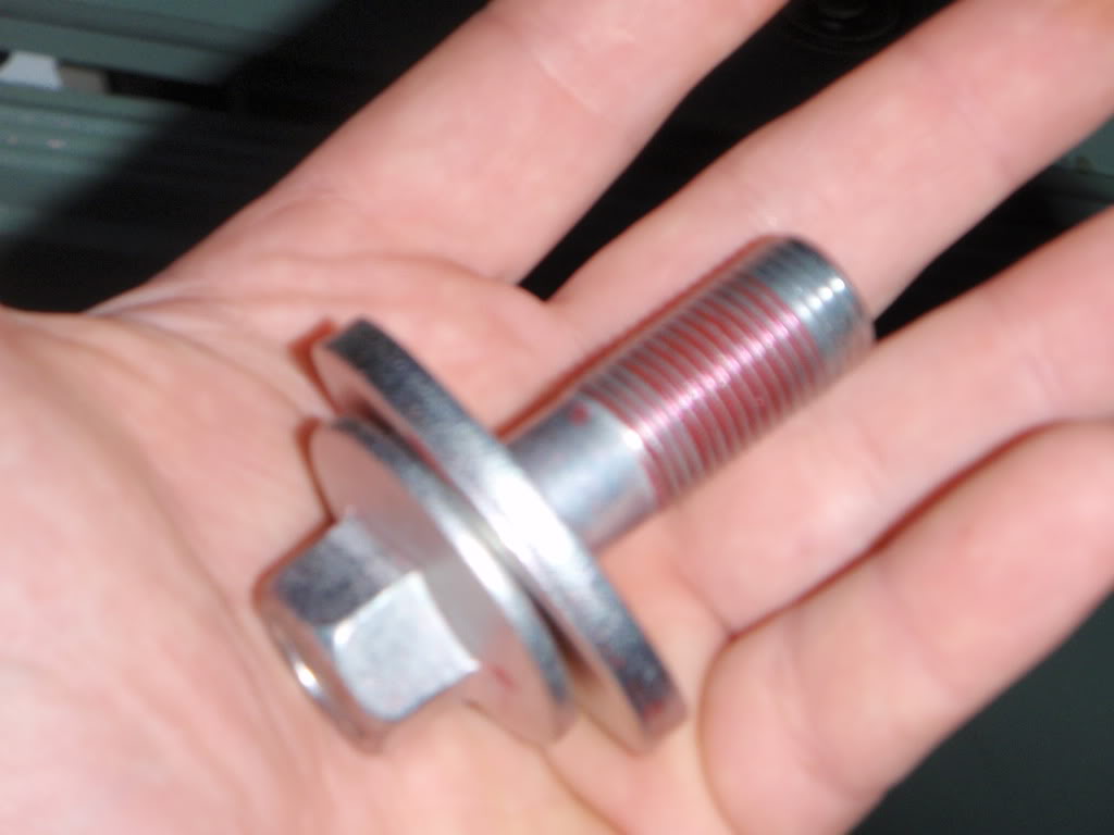

Old 02-07-2012, 04:29 PM
aa1911's Avatar
Join Date: Sep 2009
Location: Western Washington
Posts: 1,286
Received 3 Likes on 2 Posts
2000 5vzfe CS bolt... let me find my part number...
