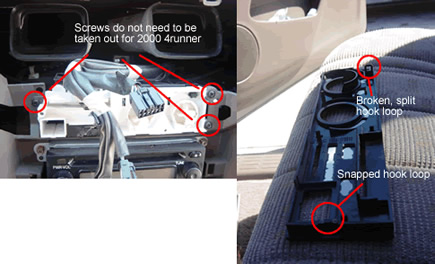

Thanks for the responses, but after taking apart the dash, I found out that the heater panel did not need to come out for the 2000 4runner. Unfortunately, I snapped the little hook loops that hold it in, :pat: but it doesn't affect how firmly it's held in. However, I was able to take it out of my parent's 98 runner without breaking it, and it did require to be taken out along with the screws. Check out the pictures:
All I need to do is pull off the whole console without removing the heater panel.

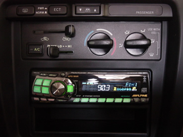

After reading some other posts, I'm a little confused. Are there any other amps in the 4runner other than the one in the stock head unit? If I wire my cda-9811 with a wiring harness, will i be using the 9811's amp or one connected at the other end of the wiring harness? I have the stock sound system and not the "premium" one.
Toyota abandoned the external amps with their newer stereo's. What does the harness look like? Can you take a pic and I can tell you if it goes to an external amp or if it is the main stereo harness.
Heh, no biggie. I already have the head unit installed...and for the termites, I'm gonna have to investigate later on today. Here's a pic of the head unit (9811).
