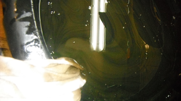

Well, I did a trans oil change and lo & behold, no teeth or bearings.
Bad news is it came out green with a silver lining....
Im assuming that means a bearing somewhere is ground right up and has been silverizing my trans oil.
Can you pull that countershaft bearing without dropping the trans? cuz that would be nice.

Old Mar 11, 2013 | 09:38 PM
j2the-e's Avatar
Joined: Sep 2011
Posts: 608
Tranny needs to come out. Might be best off pulling the trans and giving it to a specialist. Unless you have the necessary pullers and a press. The factory service manual comes in handy too.
