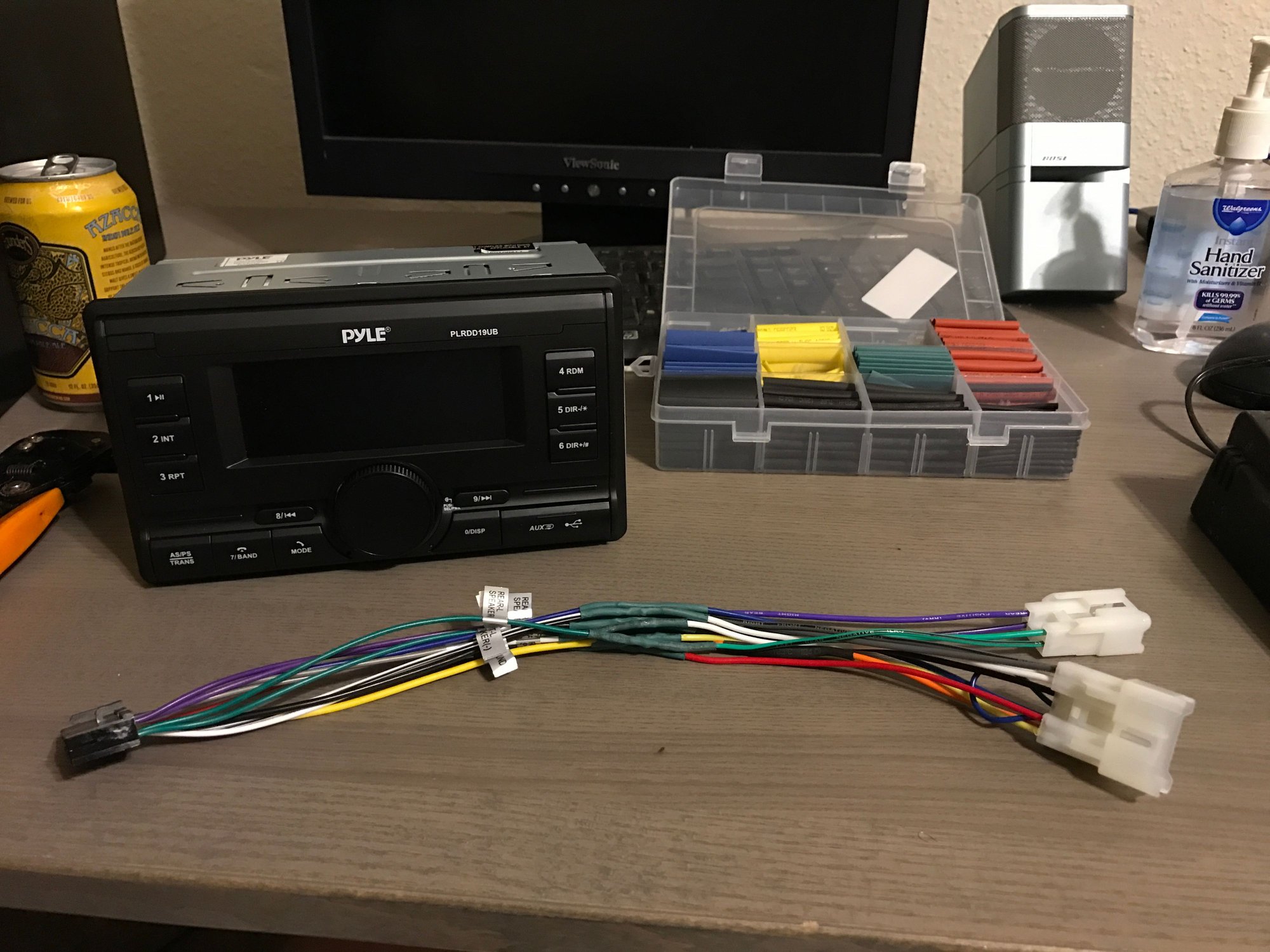

In short, this plugs into the harness that the factory amplifier plugs into (may or may not be a thing specific to premium sound system equipped trucks). So you end up removing the amp completely. This adapter is connected to the wiring pigtail supplied with the head unit, and it's a 1:1 match (even the colors are the same) except for the orange wire, which is for backlight/dash illumination. I ended up just sealing off this wire and didn't use it. Here is the wiring mated together, using solder and heat shrink:

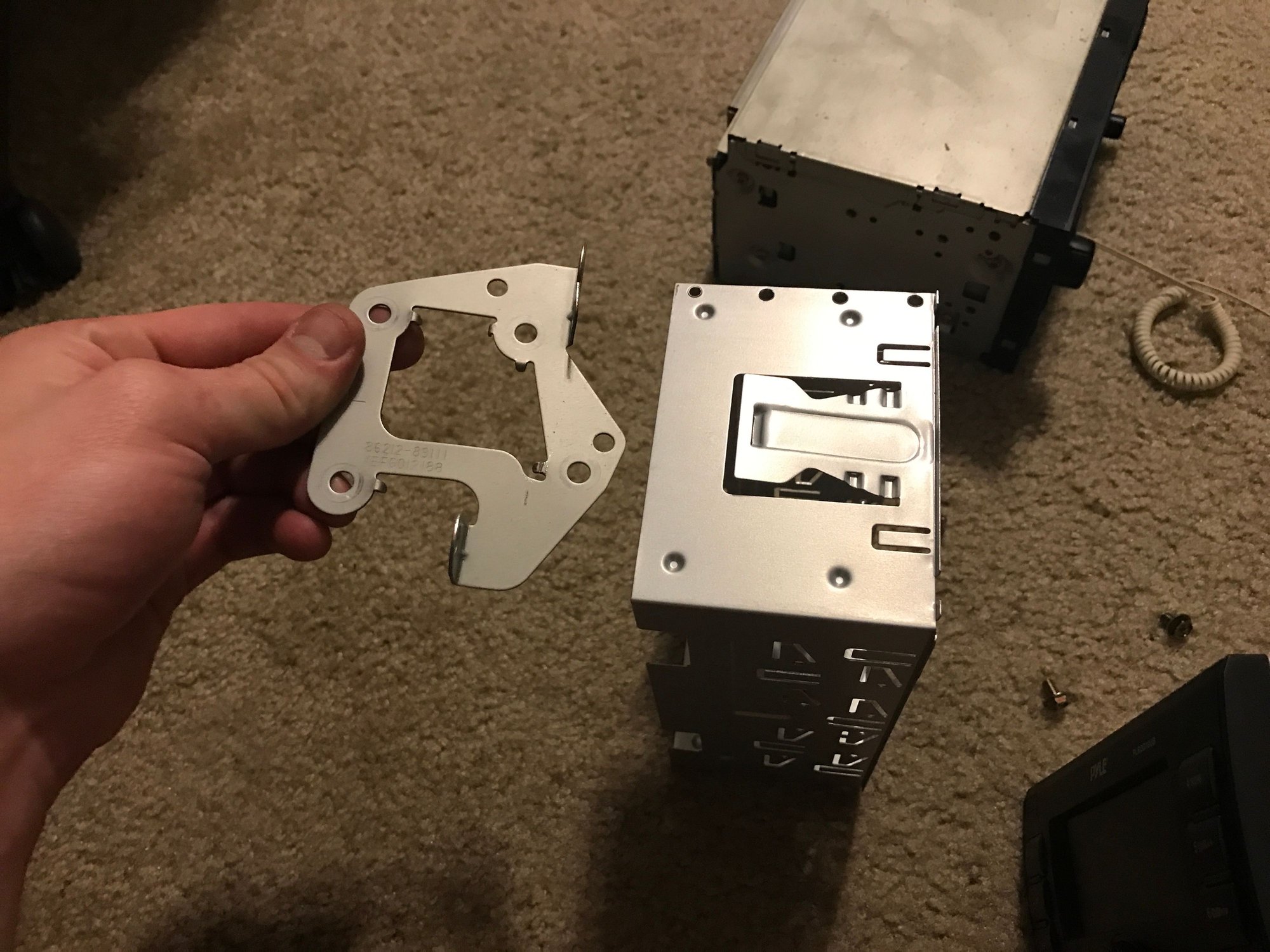

Now, the mounting brackets from the old unit need to be adapted to the new one. I removed the thin surround on the new unit to expose the mount holes. All 4 line up, but only 3 of them are tapped/threaded to accept the factory bolts. That's good enough.
The factory bracket has small tabs that protrude into the head unit - one of them, next to the missing bolt in the above photo, needs to be bent flat so it doesn't clash with the casing. It might not need to be, but otherwise the mounting brackets won't sit perfectly flat. You can see in the above photo that it's bent parallel to the casing.
Here you can see the factory bracket, next to the metal surround/bracket that the new unit came with:

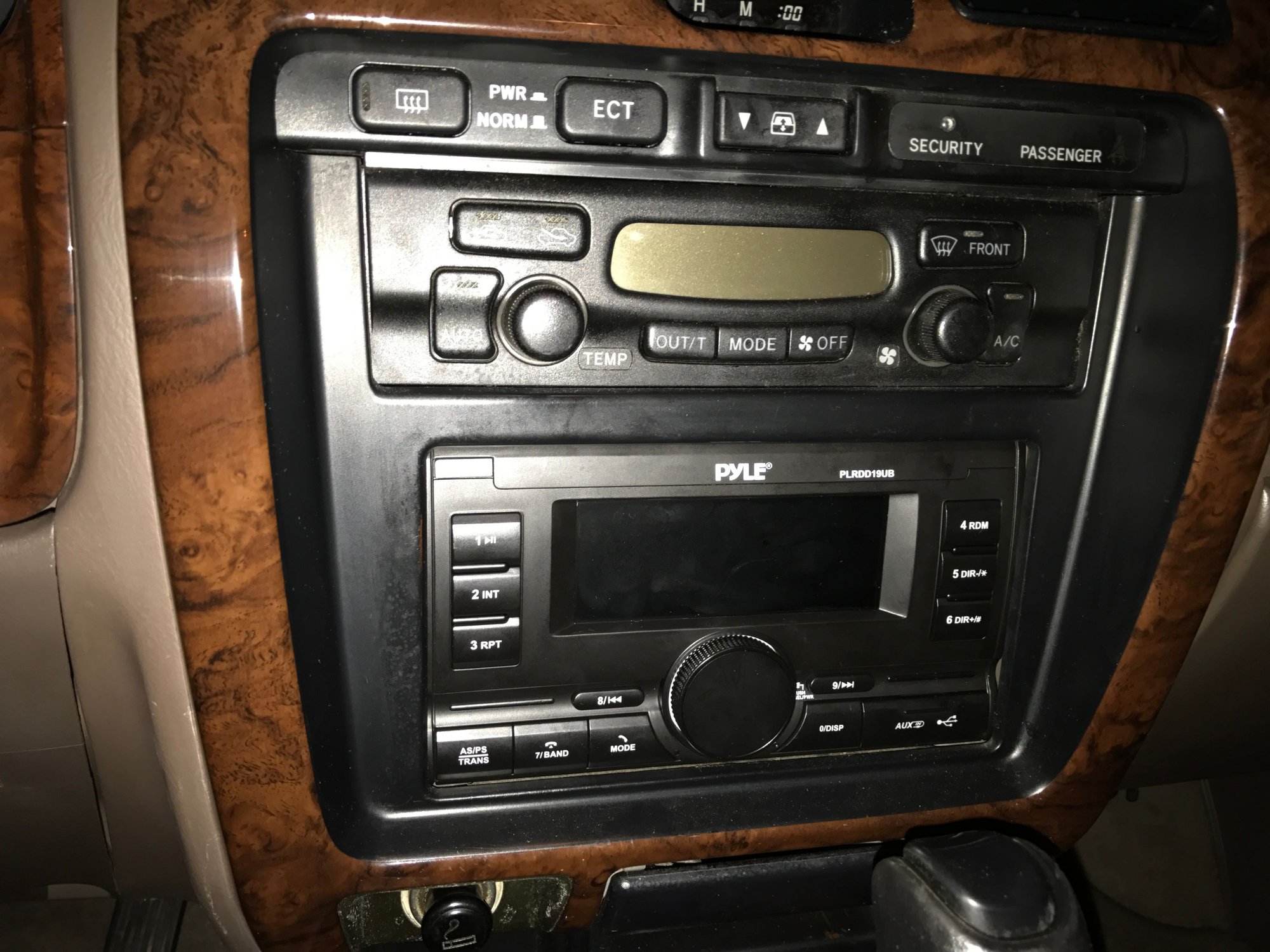

Now it's a simple matter of installation. Remove the plastic surround/trim that comes with the new unit, as it will clash with the center console trim. It comes off by lightly prying the tabs loose. I didn't take pictures of the installation, but here's what it looks like when it's finally installed:
While it's not a 100% match to the interior and green backlight color scheme, I'm very happy for the price I paid. The sound quality is just as good if not better than the stock unit. Bluetooth and hands free calling works exactly how you would want it to, and the instructions manual goes into enough detail for proper setup (albeit barely). It also has an aux. in port, SD card slot, USB slot, and other basic features like plenty of radio presets.

Awesome! I am glad you reused the factory radio brackets.
I have seen may installations where the radio was thrown in with the weight of the radio hanging in the plastic trim.
