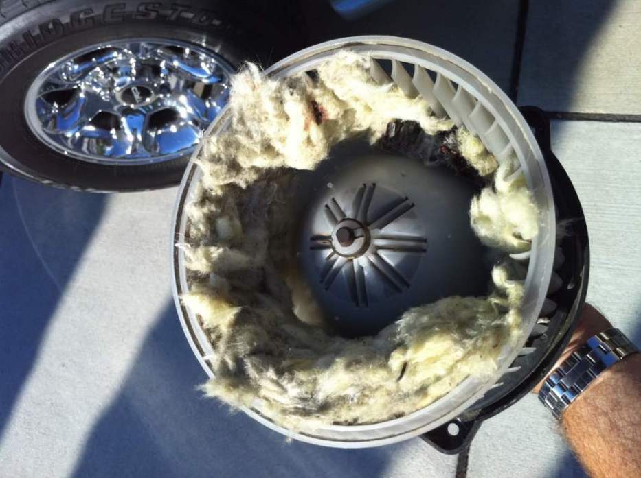

I turned on the blower and I could hear something inside moving around. It was on low, so then I put it to medium speed, then to high, then thump, lol. I then realized it was an animal probably, but it was surely dead after being on HIGH, due to the SMELL! I pulled the blower fan apart, and this is what I found, with two mice inside.

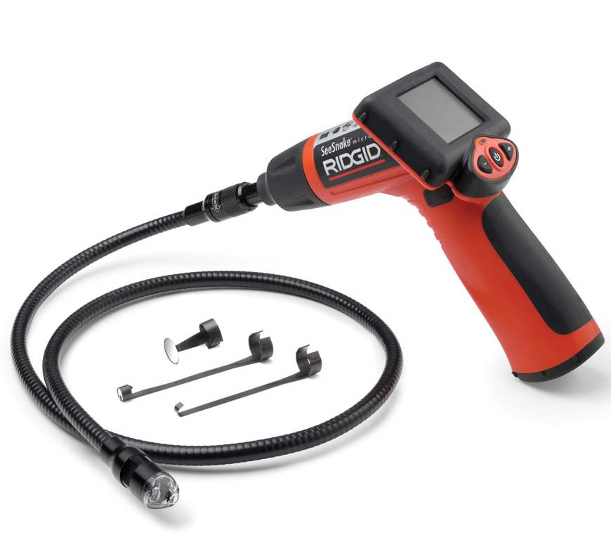

I cleaned it all out yesterday but it still stinks in my truck! I borrowed my neighbors Sea Snake (a portable flexible camera with has a light on the end)

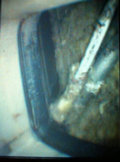

I aimed it in the channel where the fan blows the air through the big black box beside where the fan mounts, and saw this:
Yep, thats mice guts! I don't know how I'm going to get it all out of there and need some help on how to get everything apart in that lower black box area where the air blows through. Anyone have instructions on how to do this, or something from the service manual???

But all kidding aside the best best may remove the blower and use a shop vac with a smaller hose to suck out as much as you can. The spray it down with some A/C evap coil cleaner to break the stuff loose and GENTLY wash it out by putting a baking pan in the floor board and using a hose on LOW.
The only other alternative is going to be pulling the eavp coil and then you have to swap the drier, vacuum then recharge the system.
I would really be curious to know how they got in there. I would look under the hood and see how much insulation they tore off and god knows what else they tore up.

Thanks for the tips. I have a bulilding I've been parking my truck in recently, and that's where they had to get the yellow insulation from, as the building isn't finished, -- the walls are all insulation on the inside.
I was able to get most of the black cover off the evaporator and twist it down enough to get in there and get everything out (luckily I did this, as there were two more dead mice in there!) I used a smaller vacuum hose like you suggested which helped alot. There was a ton of insulation over the coils on that mini looking radiator/evaporator. I use a mixture of bleach and water in a spary bottle to clean off everything. Super clean and now the air comes out harder than a hurricane!
I did dent some of the coils a little, but I don't think that is hurting anything. I recommend everyone clean their blower out anyway, as it does get dirty over time and you are breathing it all in!
