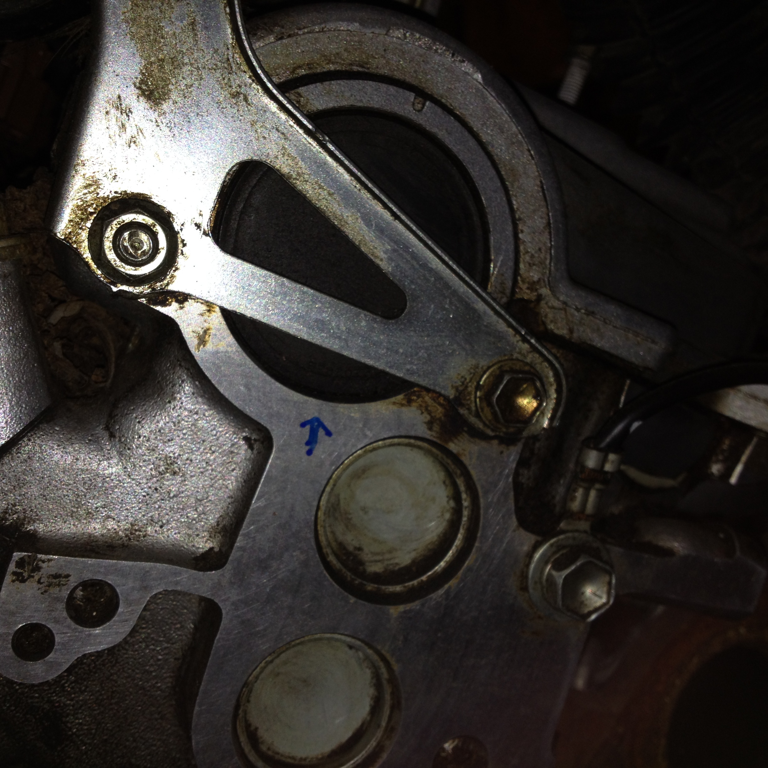

I bet you're leaking out of the sealing plug at the end of the cam on the back of the head where it meets the valve cover. I'll get you a pic of what I'm talking about in a minute.

Here you go. Look at the plug above the blue arrow.
