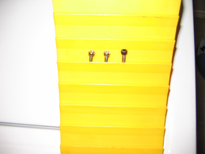

Don't even try to drill out the screw and use a extractor. Broke two different drill bits before going to the dremel. I found a great replacement bolt for 40 cents at Home Depot. Part number 30699-82558 4mmx10mm cap screw with socket head.

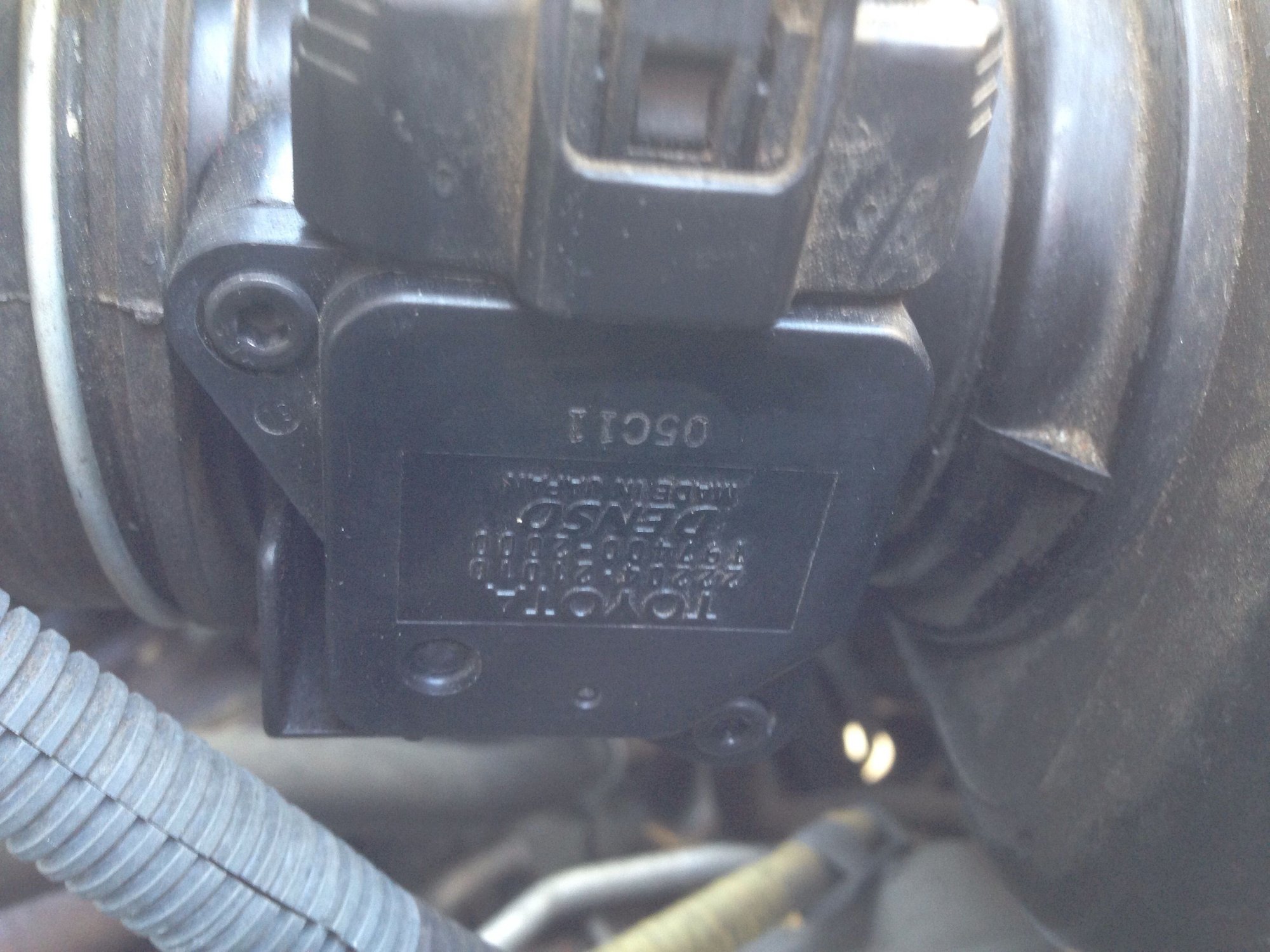

I had the same problem, and responded to a couple threads about this.
Here's what mine looked like:
I tried one of those screw extractors from SEARS but it just dug it out more.
I did the dremil trick to cut a notch and ended up heating the screw so much that it just melted the plastic around the threaded insert. I just pulled it out and found the corrosion that was causing the problem.
I mixed up some epoxy and glued the insert back in and used an alan head bolt.
Erich

Pictures of the two bad boys and the replacement. 20 cents each at Home Depot
