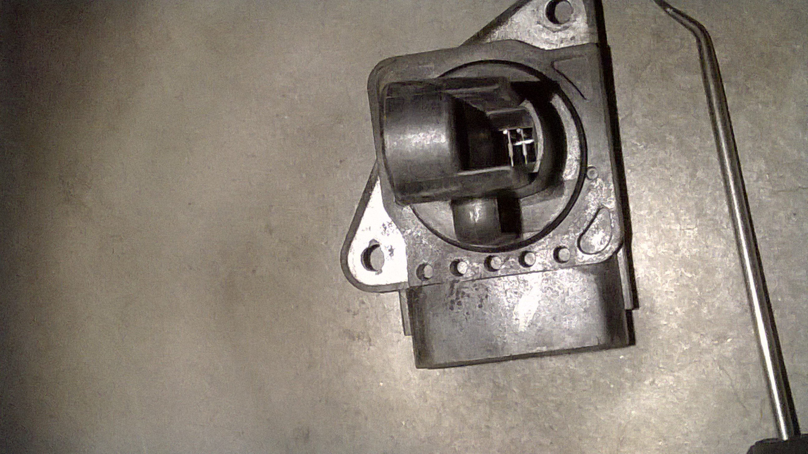

Old Apr 25, 2015 | 03:20 PM
  #38
75w90mantraN's Avatar
Joined: Dec 2007
Posts: 582
Likes: 20
From: PNW
Had to use a pick tool to clear p0171
I had to use a pick tool on the sensor wires to remove the code for my case. It came up about a month ago and would not go away despite replacing the PCV valve and grommet, air filter, cleaning the MAF sensors with the specified cleaner for it, and NOT touching the wires as advised. I also had new oxygen sensors. But when I re-checked the MAF, I noticed what looked like some debris that gotten stuck around one of the wires. I used a pick tool to gently remove it loose. After pulling the EFI relay AND fuse overnight just to be thorough, the code hasn't come back. I even passed California emissions. Try re-inspecting the wires for any gunk that could be stuck.
Here's a before and after pic of the MAF wires...
Attached Thumbnails MAF Cleaning tip..?-wp_20150406_019.jpg   MAF Cleaning tip..?-wp_20150421_006.jpg
