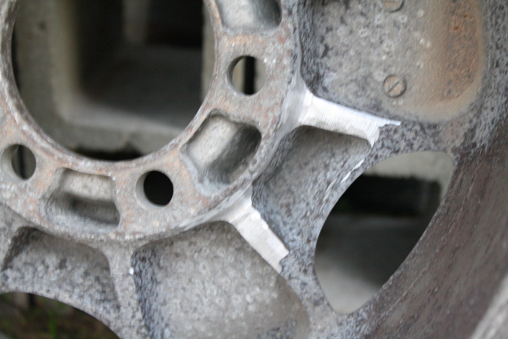

I have the LC80 wheels which are basically the same wheel on my 96 4Runner with the 231mm brakes. I had a 1" spacer on them until I clearanced the wheels to fit the calipers.

Yikes, probably not going to grind. Guess ill go with 1.25". Thank you very much terminator.
