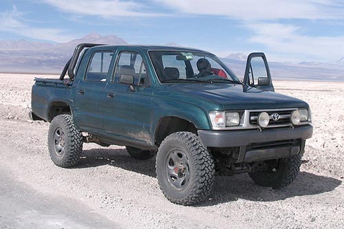

I live in Santiago, Chile. Just got the Prado on Monday, I am very happy with it so far. Tested the winch today which had never been used, and it worked like a charm! As soon as i get my camera back I wil post some detailed pics.
This was my LockRight-equipped Hilux, at the Atacama Desert:

Cool!!! thats a nice looking truck!!! I would love to see pics of the Prado when you get them!!!
