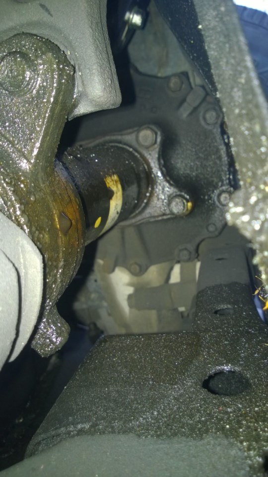

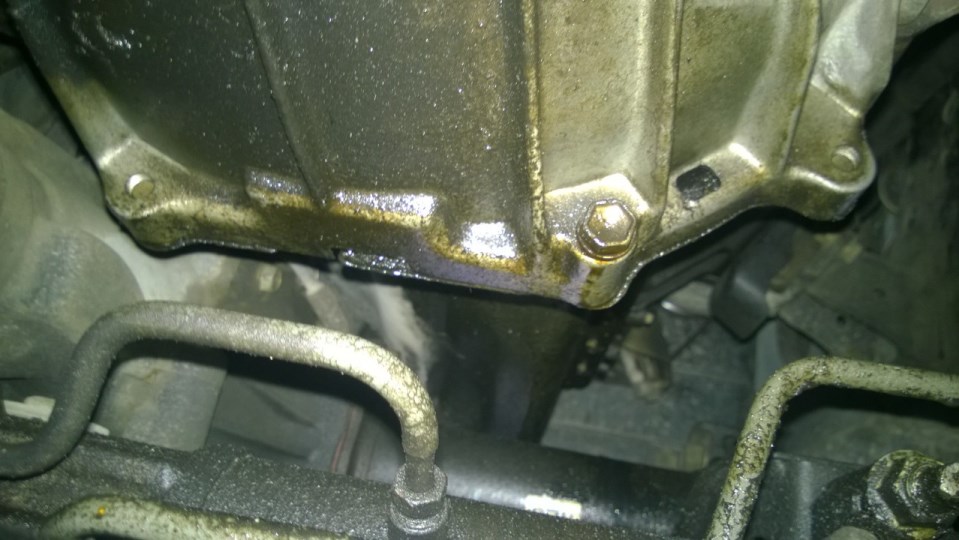

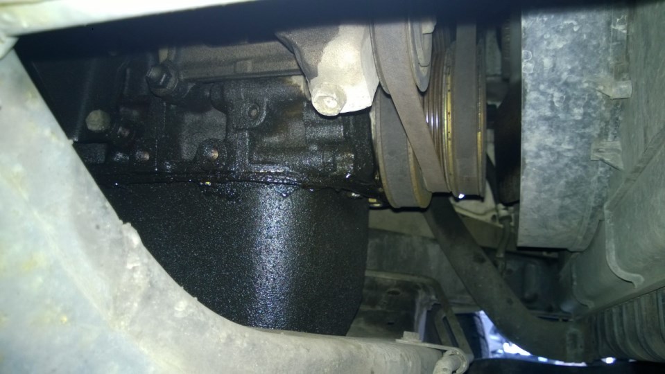

I've located a decent deal on a 99 Tacoma with 220K miles, 5 speed, 4x4, 2.7L. I drove her around for a bit and didn't notice anything unusual for a truck of this age and mileage. Steering was good, 4x4 worked, low range was good, no major hiccups, idle was a touch rough but not bad. No CEL, etc.
There are obviously oil leaks around the pan and it appears some oil has caked on surrounding components, etc. I know and work on cars but never a Tacoma. I have attached a few pics of the 'situation' and given your collective experience, I would love you opinion. Major work required, or will some TLC get me some mileage a good truck?

Could be oil leaking down from the valve cover gaskets. The bolts get loose pretty frequently. You can tighten them down but it's only about 4.7 ft. lbs.
