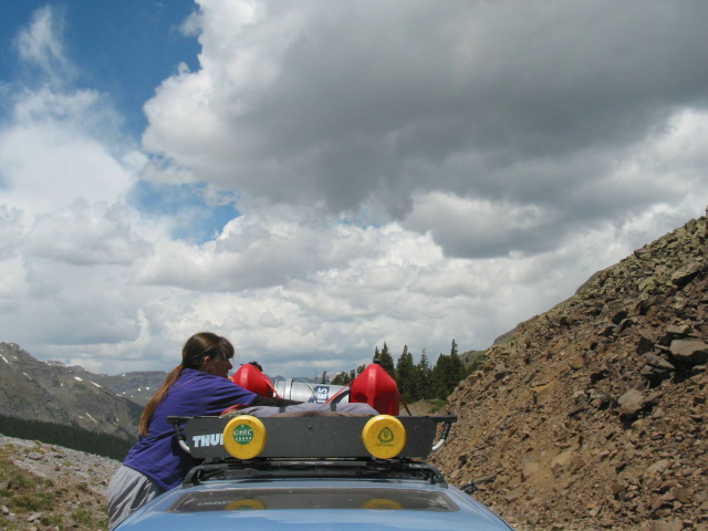

I used a stock load bar I got at a junkyard for $10. You don't have to drill holes in the roof for the wires if you don't want to!

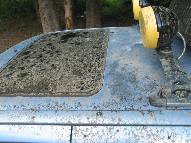

If you look closely at the above pic you can see the wire loom going into the end cap on the roof rack. If you remove that piece (torx screw) and look you'll see a white plastic vase-like thing. Cut the end off the vase thing and drill a hole through the end cap and run your wires that way. No new holes in the metal. Put a little silicone in there for no leaks

My rack's kinda tall so the lights fit in fine. Something to think about though, how 'stealth' low do you want to go?
