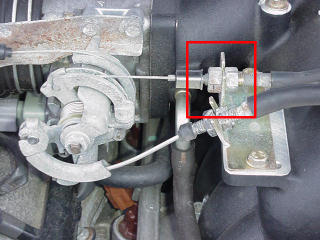

The attached pic shows the adjustment for the automatic transmission. John showed me hot to move it one way to soften the shift somewhat and the other to firm it up.
I'm sure others on this forum know far more than I what this actually does and can further elaborate just how this affects the transmission's behavior. I'll leave it to them.
As for what it feels like, it's like I said -- like hitting a small bump in the road. There's a definite jerk when it shifts, and the most noticable is when shifting into 2nd gear at low RPM.
Hopefully that helps. It's the best I can do...

That is the "kickdown" or throttle cable adjustment for the Auto Trans. If you have a service manual, there is an actual stock setting for that cable. If you tighten it up beyond spec, it will hold shifts longer and be firmer when it shifts under hard acceleration. If you loosen it beyond spec, then the opposite will happen. If it is too far out of adjustment to the loose side, it won't kickdown when you want to pass someone.
Hope this helps.

What I'd like to know is how to do this VB upgrade myself? Anyone know? Also, I don't think adjusting the throttle kickdown cable is something you should mess with, because in reality all you are doing is adjusting when the tranny will downshift and release the downshifted gear upon acceleration. For example, if you tighten the cable, it will downshift sooner, and not release the lower gear as soon. If you do the opposite, then it won't downshift as soon, and it will release the lower gear sooner.
